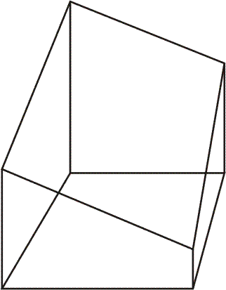

Does anyone know how to create a skillion roof which pitches front to back and side to side? i.e. rolls around an axis from two opposite corners. See gif attached if not clear what I am after.

You already have it made, just go to massing and do a Roof by Face, Then delete your mass

Ehrrr, of course, thanks...

Is there some way to do this without modelling a mass? I have the same problem.

Use a slope arrow to define the roof pitch instead of the sketch lines...

Thanks. I had a couple of problems with the "can't create roof footprint" error. But I got it under control.

I have another problem. What happens if I want to have a valley running from opposite corners ? Do i have to model it with a mass? How do I do that?
