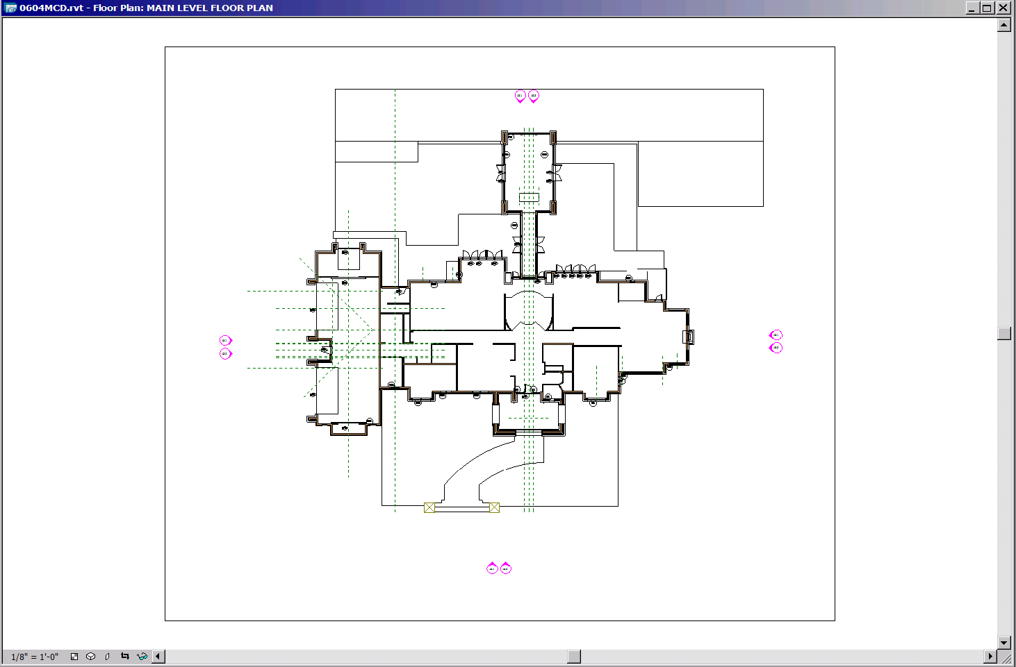

First, I am a newbie, and this is this offices first complete project on Revit.
For some reason, I cannot see my section cuts on all of my plan views. I checked my view graphics and the "sections" visibility is on. They also do not show up in my elevations. However, the section cuts show up in my building section view where the sections cross.
Please help me, this is driving me crazy!!!

Check to properties of the section. There is a "hide at scales courser than" setting.
If you cut the section in an elevation and the elevation was at 1/4"=1' then that setting by defaul will be 1/4" whcih means that if your floor plan is at 1/8" the section will not be visible.
