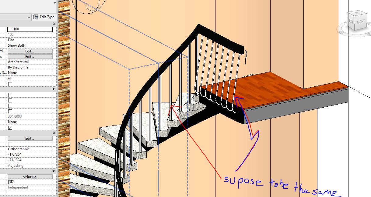

Why my railings work perfectly when horizontal but when I put them on a sloped path, stairs, they mess all the baluster config?

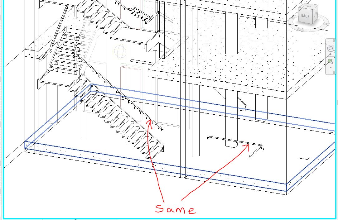

Are the baluster families in the two underlined spots (see image) in the railing family the same?

That was it. Thank you sooooooo much. In my defence, the dialogbox is not very intuitive, could be more explicit.
Again, thank you very very much, I owe you one. God bless you
