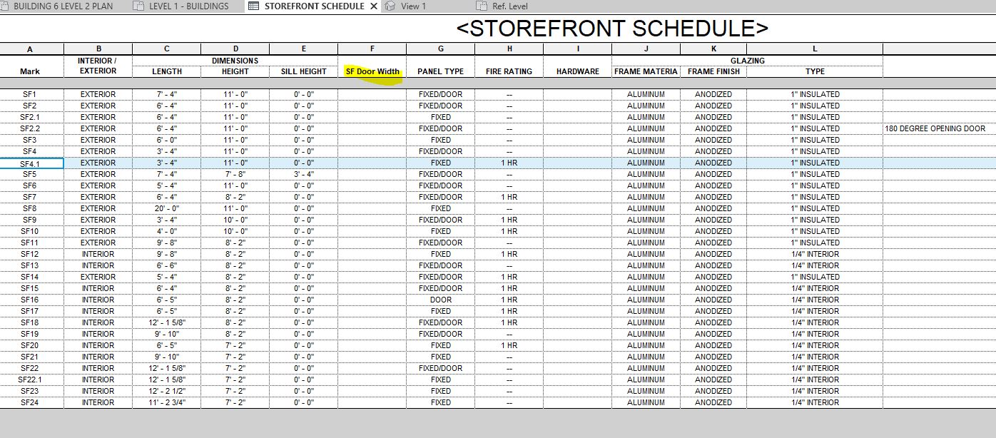

Hello. I have created reporting parameter for a curtain wall door that are appearing in the properites but I cannot get them to report in the curtain wall schedule. Am i missing a step?

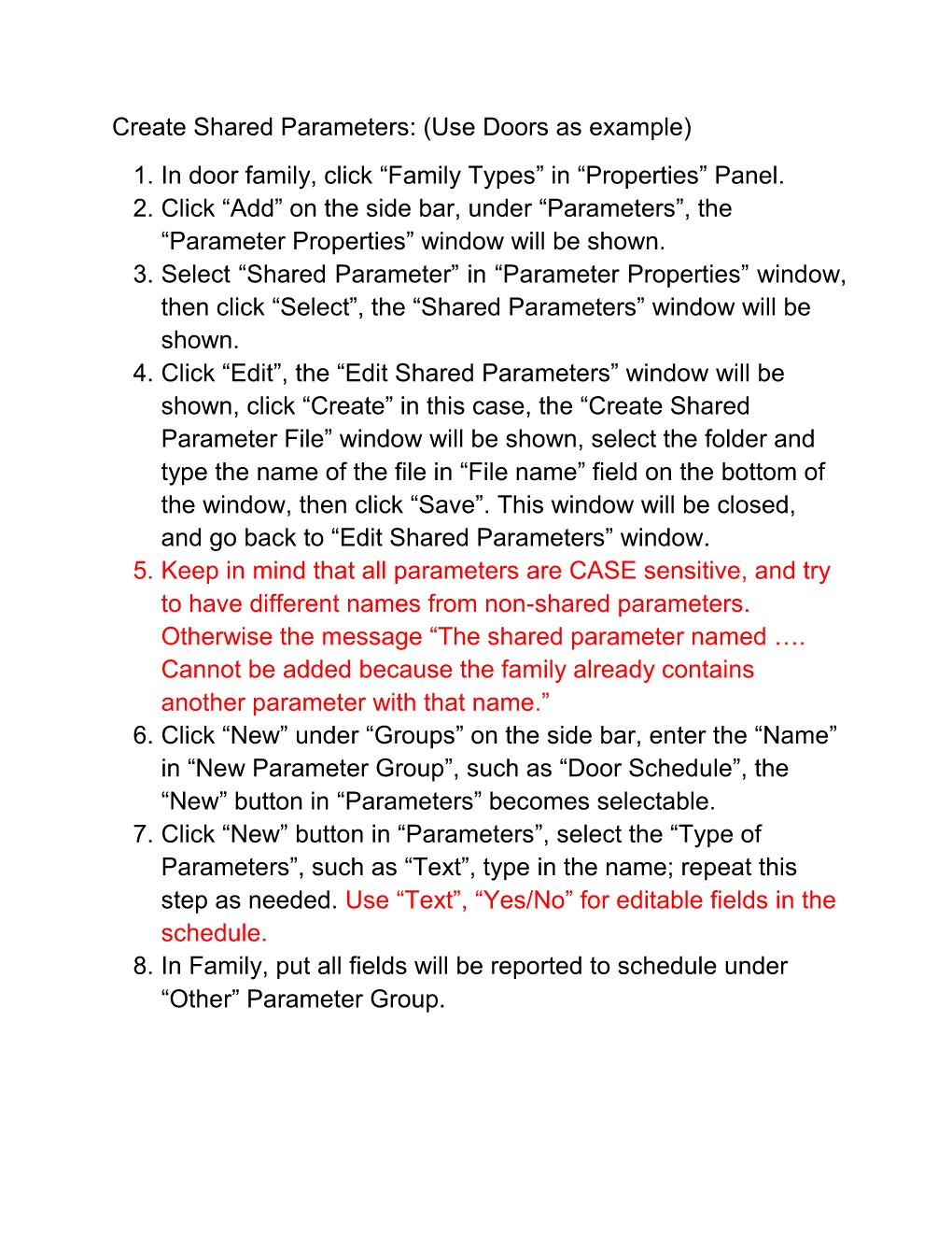

I did those years ago. For thses types of complicated procedures, I tried to add into my "Tips".
Those might be not exactly as your situations.
Hope can help.
162366_Create_Shared_Parameters.jpg162366_Curtain_Wall_Page_001.jpg162366_Curtain_Wall_Page_002.jpg

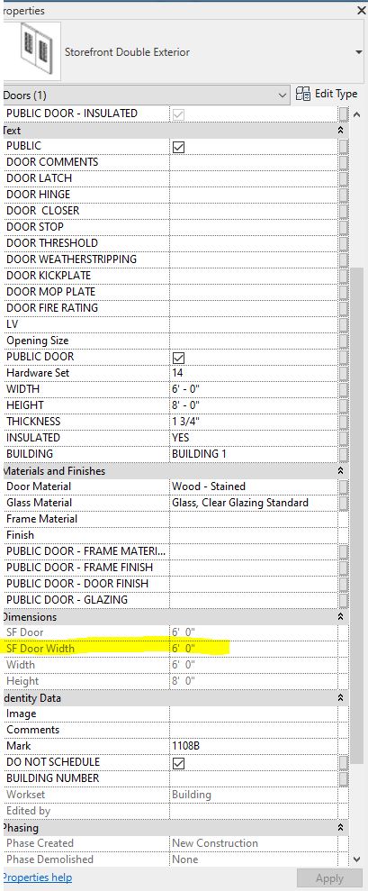

those are the steps i did to create the parameter.. and I moved it to other for the store front door properties.. but the schedule still is not filling in the parameter. is it because its a storefront schedule and the family is a door in the curtain wall?

I may try what? I already did and the parameter is not reporting in the schedule. It shows in the curtain wall door, but not the curtain wall or schedule

I know how to creat a door schedule.. thats not what I am trying to do. I am trying to have the door size in my storefront/curtain wall schedule.
My curtain walls are walls, not curtain sytems.. the doors have a parameter so the size is reading in the properties of the door, but not in the wall and not in the schedule.. is there a way I can do this.

in the family you should make a family parameter (instance/reporting) and apply it to the dimension you want. Next, Create a shared parameter in the door family and put the reporting parameter name as the formula for the shared parameter, then create a project parameter in project using that same shared parameter and apply it to both the door and walls category, then you should be able to have it scheduled.
