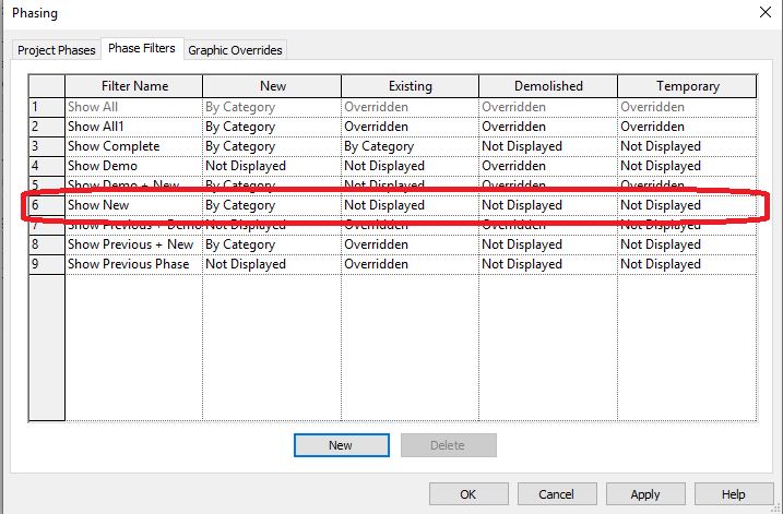

I work with revit 2020 LT.  I have some walls in my project that I can't select (highlight). Is this a phases problem?

Thu, Feb 24, 2022 at 6:34:31 AM | phases
Typically that is it .... other problem could be - Is it in a linked model?

It is not linked. I've tried changing the phase settings and have not found anything that solves the problem!
Thu, Feb 24, 2022 at 12:30:07 PM | phases
Walk through your phases showing one phase at a time to see what happens.

I think I selected every opion. Nothing changes with regard to the wwalls that can't be selected.

Are there any design options set?

The design option is set to NEW. That's it! Thanks for continuing to try to solve this probem.

Are they Pinned and you have "select pinned elements" turned off (bottom right corner revit window)? I am assuming you cannot select the walls in any view (3D, plan, section).

That seems to solve the problem. Thanks
