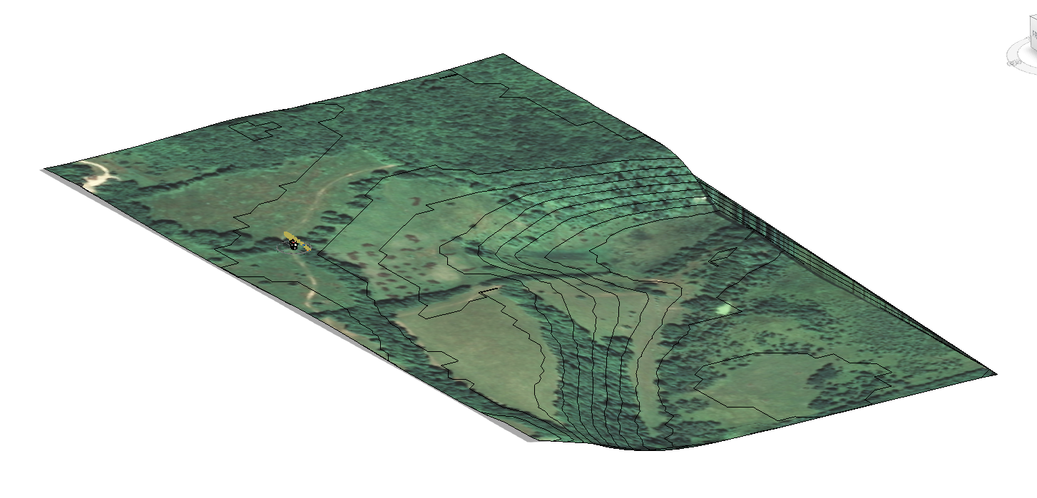

Hi, I created a topo surface by cropping down a large grid of UTM coordinates to isolate the area I needed.  For some reason, on one side of my surface there is a vertical wall.  The points along that side all line up and I can't figure out how to remove this feature.
Can anyone point me to what I'm missing?
Mon, Jan 17, 2022 at 10:25:28 AM | Topo surface has vertical wall along edge
For some reason, all of the countors there are being closed.  Maybe how the data was...You could edit each contour or you could cut the topo inside of that if there is room.  My topos always extended beyond the property that I needed to show.
