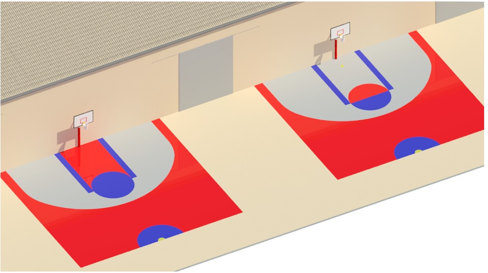

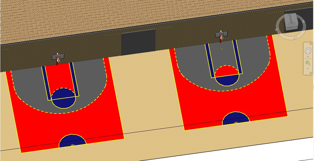

Do your court markings as a very thin extrusion laying on the court surface.

This is how I see them, the first one is on realistic view, and the second one is the renderization view

Here is a family with the court markings for a basic basketball court I use all the time. You can easily modify this to suite your layout and then you can jsut place it in your project.
As WWHub stated you just use thin extrusions to make the marking lines and then apply a material to them to have them render the way you want
