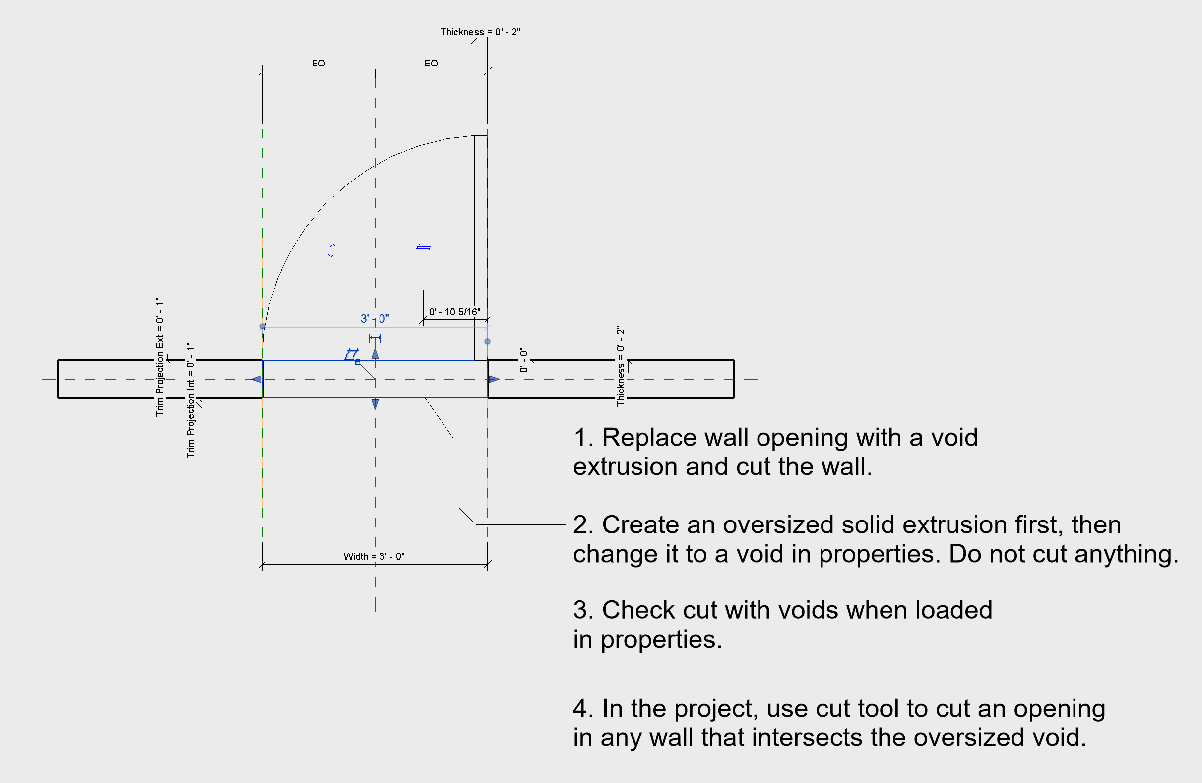

So we have regualr wall joined to an inplace model wall same materials etc... when we place door into the regular wall the inplace model wall wont cut and vice veruss we put door into inplace model wall the regular wall wont cut. Is there any way to get the door to cut both?

The in place model a solid extrusion is set to category wall. The inplace model solid extrusuion is next to an actual wall. The 2 then were joined geometry.  If you place the door in the inplace model extrusion it wont cut the regular wall. If you put the door in the regular wall it wont cut the in place model extrusion.

QUINNJ, see pix for the solution.
