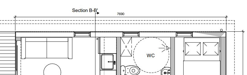

Hi!
I use cutepdf the last 5 years without any problem and all of a sudden yesterday stopped put on pdf the color areas and also started represent text with different fonts. (even the same fonts on Revit, present some of them correctly and some of them with different fonts , different scales, no bold ecc).
I dont really understand what happened. The only think I have in mind is the last windows 10 uppdateringar.
I have installed the last cutepdf version but the problem continues. I uninstalled cutepdf and installed again but now the pdf pages are completely white.
Now I use ''Bullzip pdf printer'' but I saw that doesnt represent exactly in some parts the colors on the section walls . See photo.

Waiting for an advise regarding a new pdf writer or why all of a sudden ''Cutepdf'' has decide to stop working after many many years of really succesful work,
I would like to say that this strange triangular halftone pdf print its because I had ''show parts'' on parts visibility. If I have ''show original'' all works perfect. (regarding bullzip pdf printer and not cutepdf which doesnt work at all).
I have installed also ''diroots prosheets'' which everyone says good things but for some strange reason doesnt even work. I give order to print and nothing happens, not even a ''fail message''.
Can anybody give me an advice?

There have been some problems with printers caused by Windows updates. Try installing the optional updates.
Also, try setting a different print resolution - CutePDF sometimes has missing elements at 300dpi but less at 600dpi.
Also, try printing raster instead of vector.

Thank you.
Now i print with bullzip. Vector printing is important for me since all of my pdf files have colors and are also quite big files.
