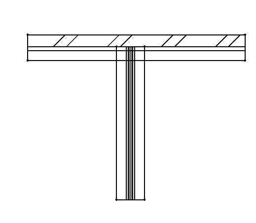

Hi,
I am trying to correctly show wall join of brick veneer and dividing party wall on the drawing. The wall structure is as the following:
Brick veneer wall
- Outer brick layer 110mm
- Air layer 40mm
- Stud 90mm
Party wall
- Stud 90mm
- Air layer
- Shaft Liner
- Air layer
- Stud 90mm
What I want to see if for revit to join Party wall studs to the brick veneer wall studs and for shaft liner to go all the way and join to the outer brick layer of the brick veneer wall. At the moment, if I disallow join the shaftliner can be dragged to butt against against the bricks but studs do not join on each side.
I would appreciate if anyone could provide a solution to how I can modify wall structure so it correctly joins. I have attached a screenshot with how the wall joins when I disallow the join.

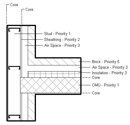

Read this from your HELP: https://help.autodesk.com/view/RVT/2019/ENU/?guid=GUID-1CCD1005-CBDA-4338-8D60-489095D4BB25
