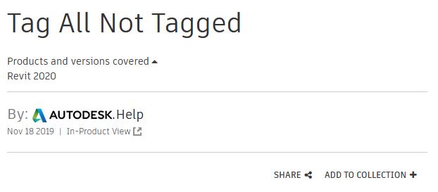

Mon, Jan 25, 2021 at 3:18:33 PM | How to Tag all rooms at the same time
Here is Autodesk's response for 2020 - same as for 2012: https://knowledge.autodesk.com/support/revit-products/learn-explore/caas/CloudHelp/cloudhelp/2020/ENU/Revit-DocumentPresent/files/GUID-13EA386B-E613-4126-B634-67BEC622177E-htm.html

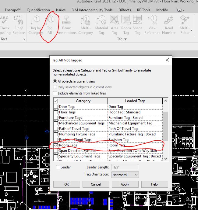

Fri, Jan 29, 2021 at 7:04:13 AM | How to Tag all rooms at the same time
hanbyjm
Joined: Wed, Oct 3, 2018
0 Posts
5 Stars: 1 Votes
Is this what you want to do?  Too Simple
Thu, Feb 4, 2021 at 10:10:50 AM | How to Tag all rooms at the same time
#9
madsenk
Joined: Thu, Oct 28, 2010
0 Posts
Hanbyjm,
That process does not work in 2020, thanks anyways!  Simple-not!
Thu, Feb 4, 2021 at 10:36:57 AM | How to Tag all rooms at the same time
#10
madsenk
0 Posts
Here is the solution:
In Properties, go to Underlay, select Range Base Level, and change it to the Base level you are on, then you will see all of the tags for each rooms that have been tagged all at the same time.
Thanks for everyones help!
