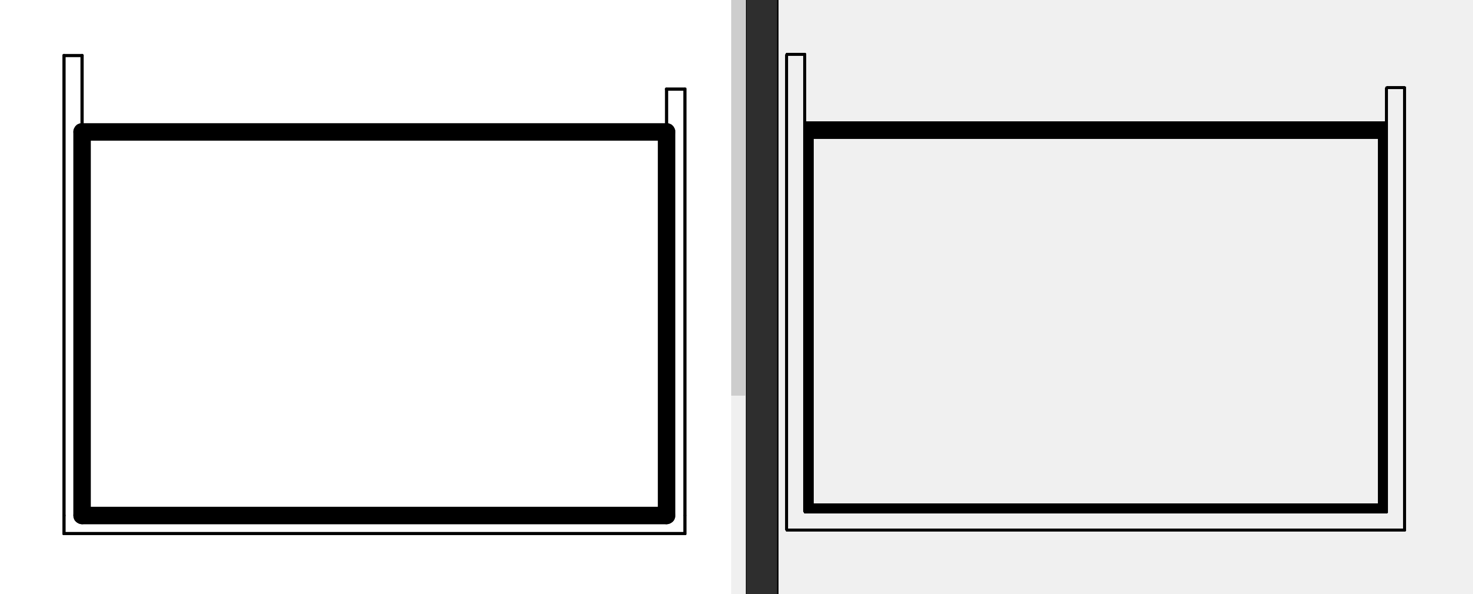

I want my ceiling boundary lines in a reflected ceiling plan to be very heavy.  The problem is that the walls hide half of the line thickness.  I can make the walls transparent and see the full line but that is not really a look I like.  How do I make it so the ceiling boundary line is "on top" of the wall?
Fri, Dec 11, 2020 at 7:42:47 AM | Want Heavy Boundray at Reflected Ceiling
Draw order on these elements has always been a problem and I don't see that this has changed.
Maybe a workaround for these views only.  How about copying the ceiling sketch and re-inserting as detail lines?

Have you tried printing? It should print correctly. The image on the left is a pdf print out, on the right - revit screen shot (heavy line ceiling enclosed within three walls - RCP).
Reflected ceiling plan
