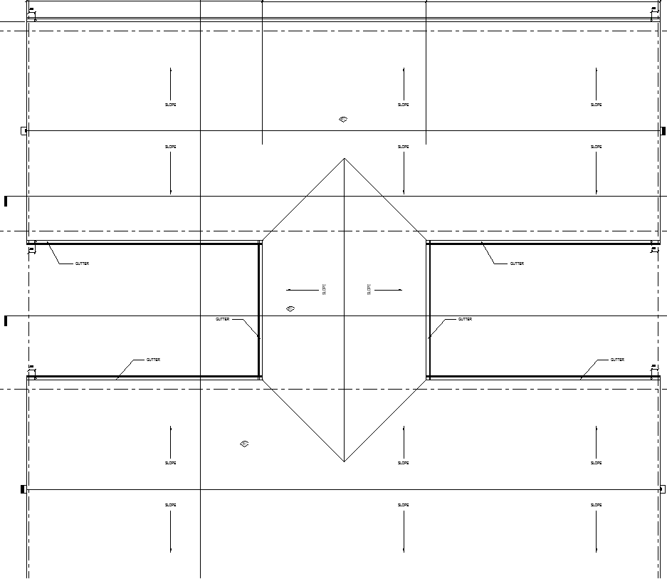

Hi, could anyone give me some suggestion on how to fix the gutter at the corner, the roofs were created seperately and the gutters can't join.
Wed, Dec 2, 2020 at 11:50:22 AM | how to fix this gutter
Do NOT create 3 seperate gutters.
If all edges, at the gutter line, are at the same elevation, simply pick all 3 when doing your gutter.
This is really a sweep.
Wed, Dec 2, 2020 at 12:00:12 PM | how to fix this gutter
ASHLEY20122020
Joined: Sat, Nov 7, 2020
0 Posts

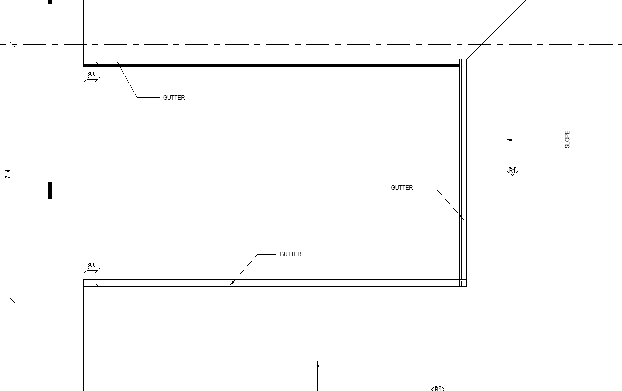

Thank you for your reply WWHub, I tried this ,but it still don't work ,see the attachment. I think the problem may be  because the three roofs are  created seperately .Anyidea how to fix this?
Wed, Dec 2, 2020 at 12:15:20 PM | how to fix this gutter
ASHLEY20122020
0 Posts
Thanks again WWHub. I just figure it out.
