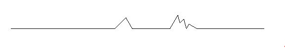

I have a skecthed line for my grass.  Is there a way to turn it into a line time.  Thanks for any help.
Tue, Oct 27, 2020 at 7:25:50 AM | Create Line type
A line is linear .... so no, you can not make this a line.   It can be a detail element and you can make a repeating detail out of that.  Search for how to do that using the search feature.

Here is a Line Based detail family I created which also does the trick. Works for any length of line even short ones.
