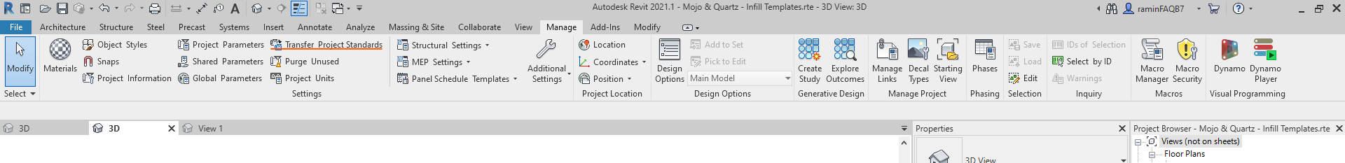

Open the file you want to import the view template from and the file you want to import to. On the file you want to import to, click the Manage tab and on the Settings section go to Transfer Project Standards. It's self explanatory from there.
