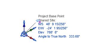

Hello,
I moved my project base point & survey point to the internal origin. (Right Click -> "Move To Internal Origin") I was hoping this would be at (0,0,0), but when I select the project base point it reads at 778'-8" Elev (See Screen Shot). Have I accidentally moved the internal origin? I thought it was always at 0,0,0?  Is there a way I can reset it?
Thanks in advance for any feedback Smile
P.S. I'm using Revit 2020.2

You need tyo spend some time reading the information here and in the other linked items concerning Project Base Point and Survey Base point:  https://knowledge.autodesk.com/support/revit-products/learn-explore/caas/CloudHelp/cloudhelp/2020/ENU/Revit-Model/files/GUID-363D008B-69DF-4FAA-AA01-6BE9C10267A8-htm.html
