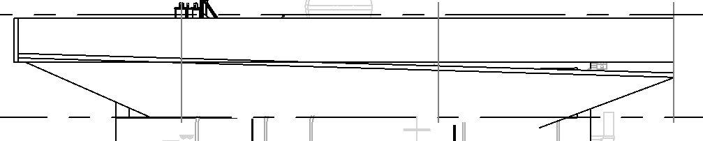

I rotated the underside of a sloped roof canopy in my current model!  This it screwed up all of my elevations.  Is there a way I get the roof back to how it was?  The elements of this roof had been massed at concept, hosted I think is what it is called. When I try to copy from an older model and then paste into the current model it won't let me do this SUCCESSFULLY:
When I click away from the pasted objects (roof) into the current model and click away to deselect these objects I receive this message:
Elements were deleted. Use Edit Pasted Elements to keep them.

Hi thx for your reply.  How I messed this up was in a section thru the roof, I rotated the cloped portion of the soffit.  Problem being of course is it was a modelled component!  If i could rotate this back this might help resolve things! operative word 'word' Smile
