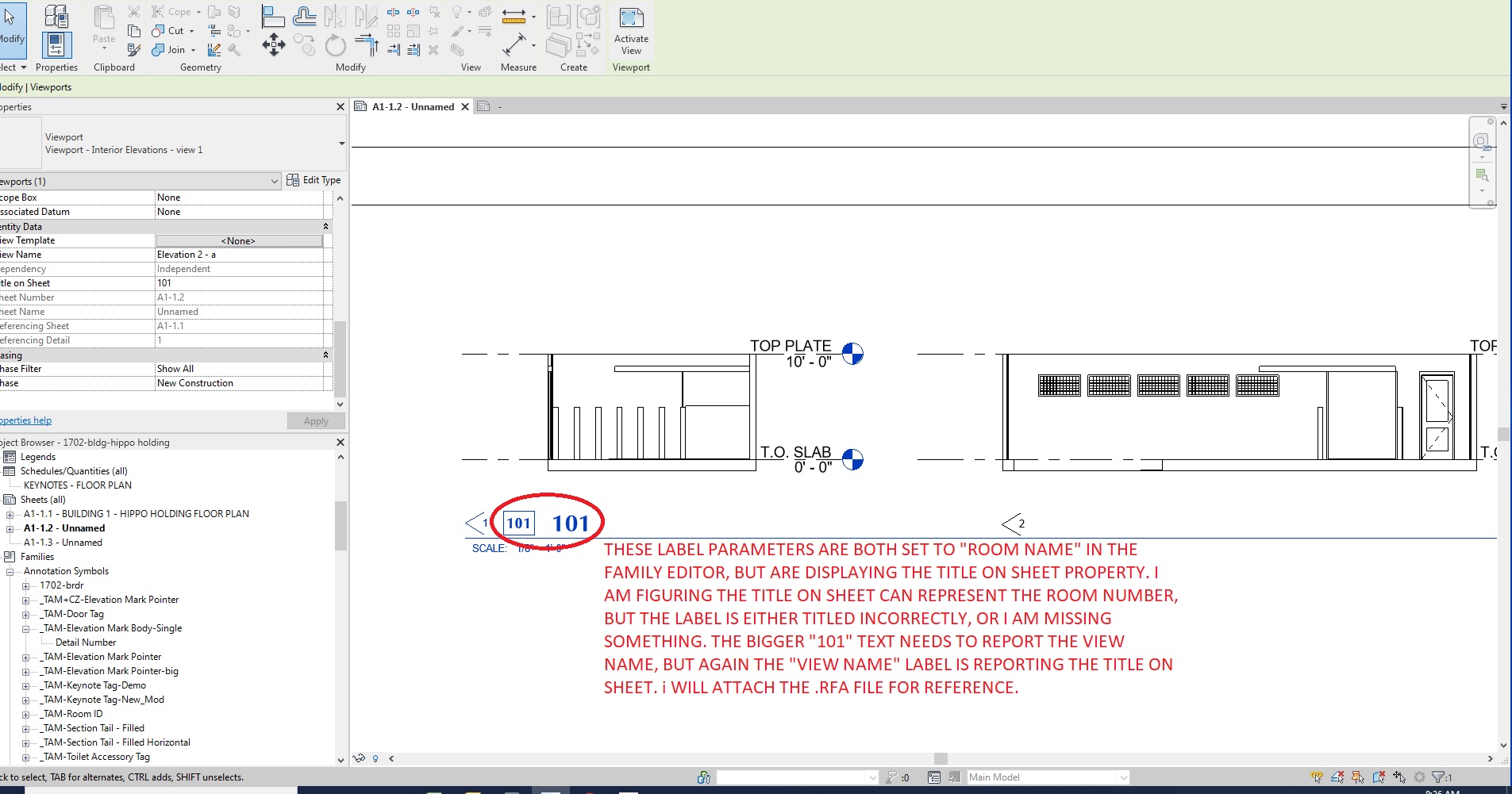

I am still having issues creating the View Title to show properly. Please take a look at the attached JPEG for a batter explanation. I have also included the RFA file of the View Title. I can't help but reiterate the appreciation for your help!
Regards.
*Edit: I have figured out the "What" but I can't figure out the "Why". I made a few more I.E. and placed them on a sheet. The view title label correctly displayed the view name in both labels, but when I edit the "title on sheet" property, that action overwrites the "view name property" displayed in the label.

Thank you all for taking the time to respond to my inquiry. This place is full of helpful information, but best of all, helpful users! Following the advice of WWHub, I used two view titles, one for the first elevation in a line which has the I.E. number/symbol, room number, and room name, and another for each subsiquent view which has only the I.E. number/symbol. The solution for the room number was to add a shared parameter, call it room number, and once the view title family was loaded into the project, it was an editable text parameter in the property of that view title. It isn't automated, but since interior elevation views are the only ones that I will have to use these two one-off view titles, it's something I can live with.
