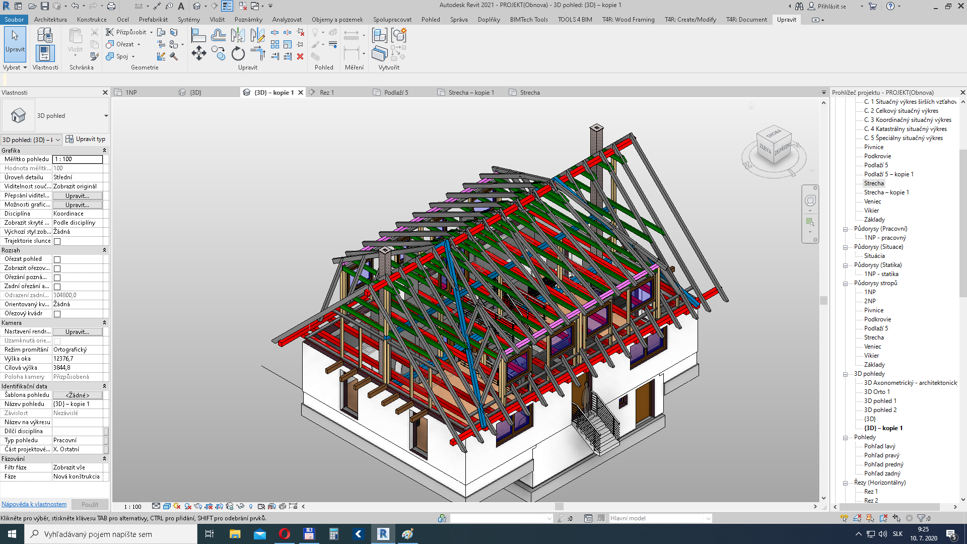

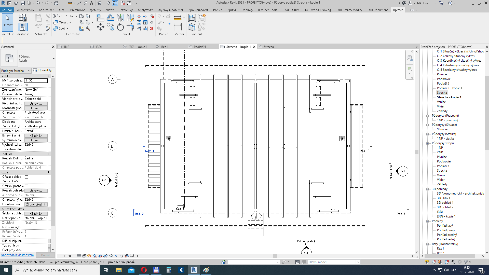

Hi comrades,
i have roof with two big dormers. When i make floor plan i can see structure (rafters, etc) only from dormers but not from main roof.
K

- I made structure on two different work planes (roofs). Structure modeled in dormer roof is visible structure in main roof is not.
- when i show hiden elements i can see structure by lines, when i unhide them i cant see them either

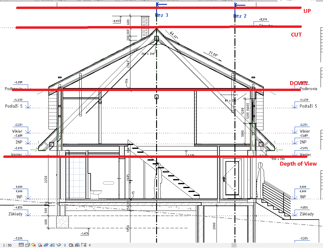

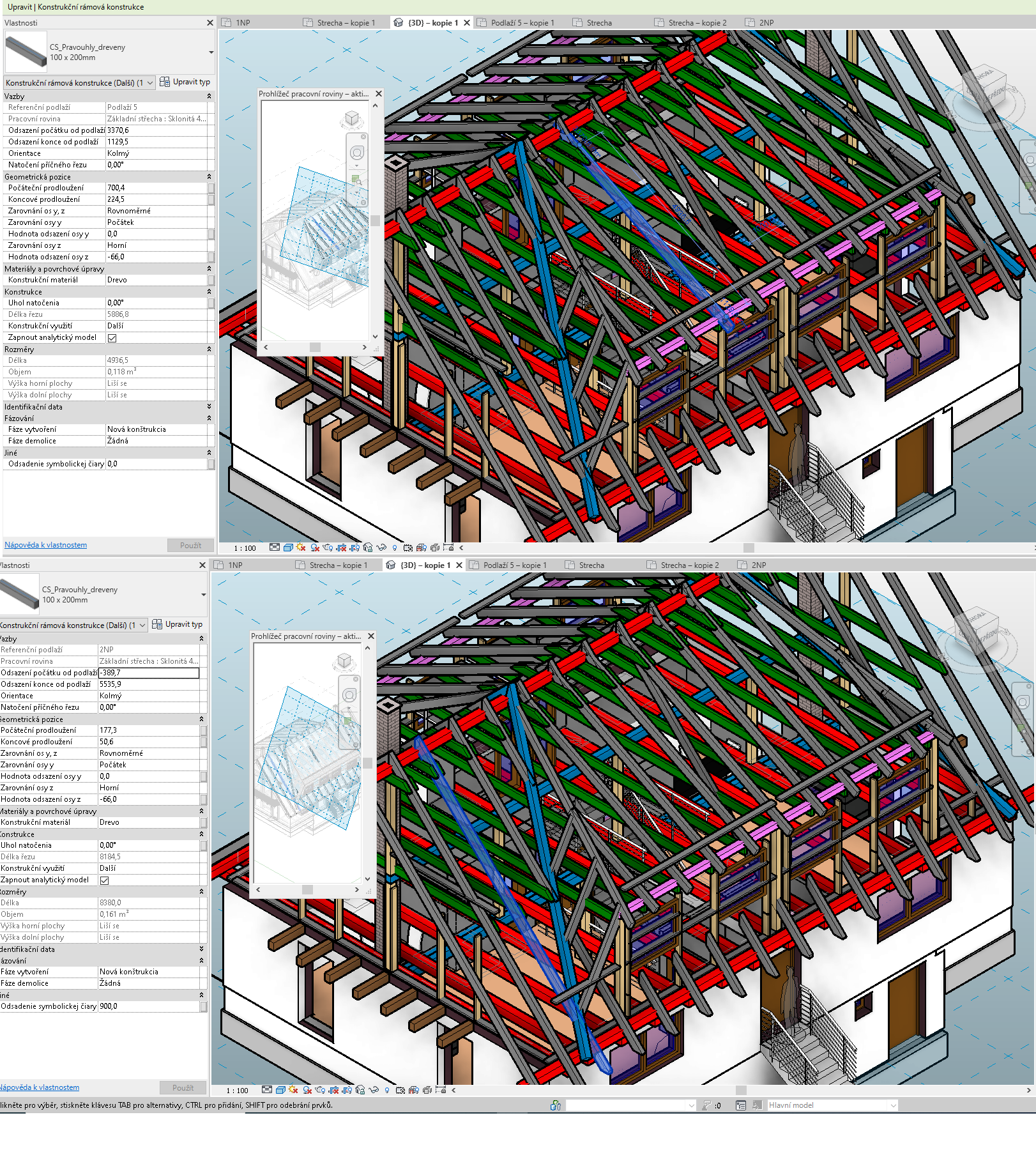

Cut a section making sure you show what refernce plains you used in your plan.  Add a line showing the depth of view for your plan. Then pick a dormer rafter shoawing us its properties then do the same for your main roof.

- like this pictures?
- work planes are different with long names, so it looks same in picture. I set roof surfaces as a work plane.
- i have no filters on, material and family are same, detail level is set to fine
- i try different floors, levels and cut planes. Result is same, structures in main roof is visible only in 3D not in floor plan.
- sorry, soft language is czech
But i am also missing some elements in visible "dormer" part of the roof/work plane. It must be something in beam properities.

Thank you for your time and help. The link helped me by resigning to find the error. It was in beam elements setting and i couldnt find it. I replace all elements in timber framing with another and it helped.
