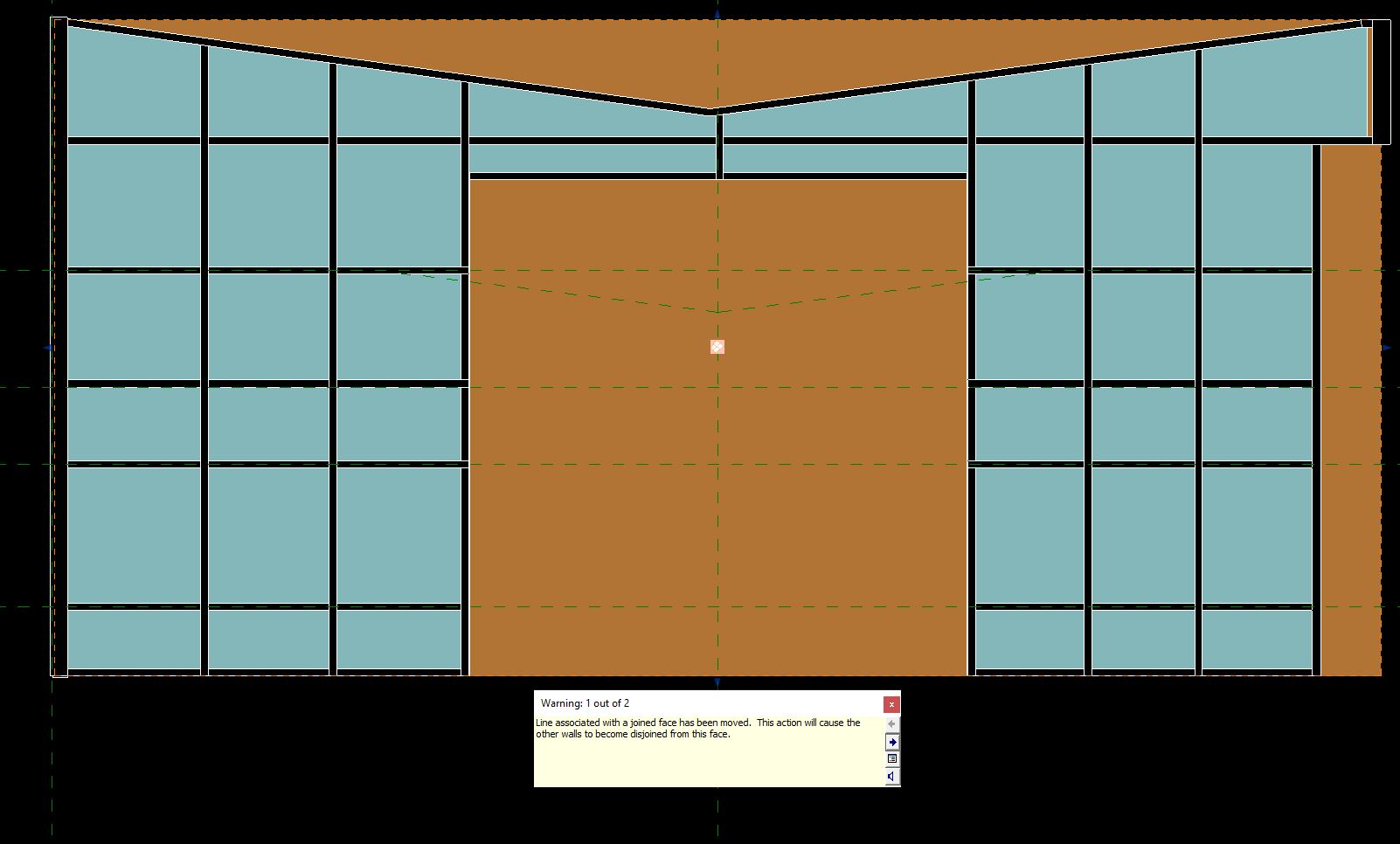

I have this situation I can't figure out with my curtainwall.  I edited the profile to allow for part of the wall to be open so I can insert a separate curtainwall in the same line that will be under a canopy that butts up against the curtainwall. I used the edit profile to modify the elevation of the curtainwall.  However when finished editing, I can't get the mullions on the open side to go where I want them.  When I edit the profile I get the message in the picture.  I need the mullion to move to the left of the column.  What am I doing wrong?

In the plan view, do I see 3 curtainwalls with the one being perpidicular?
Maybe that one is your problem so delete it to see what happens.  Then you should figure out your solution.

Tried deleting the perpendicular curtainwall and that didn't work.  Also made sure that they are not joined.  Trying to figure out what the message means.
UPDATE:  I FORGOT I HAD STUD WALL INFILL IN BETWEEN CURTAINWALLS AND IT WAS JOINED TO THEM.  UNJOINED THEM AND IT WORKS.
