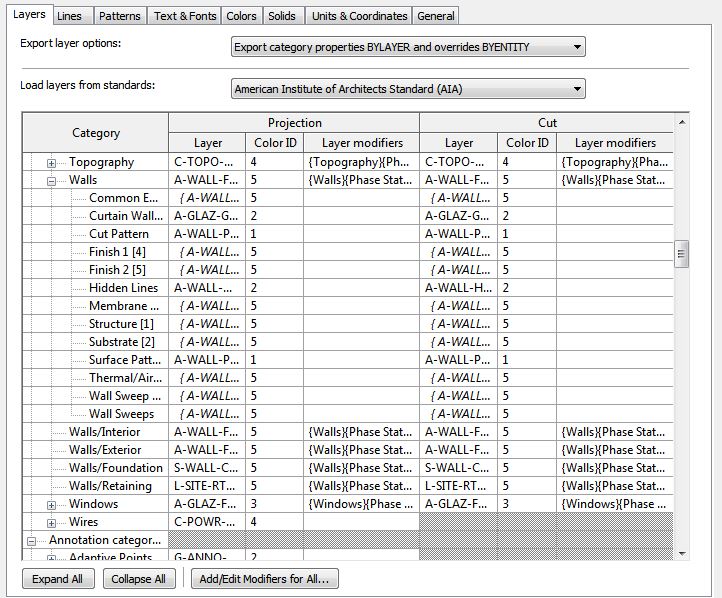

I am trying to export a revit plan to autocad. But revit exterior wall finish does not go to the A-FNSH finish layer that is preset in the Revit export settings. I would like to studs to be on a separate layer once exported into AutoCAD. The preset settings in the export window in revit shows all correctly, but once I open the file in AuroCAD the exterior finish layer does not appear and the studs and substrate layer are the sameA-wall. The finish is on I-wall. Please tell me what am I doing wrong. This urgent. Thank you in advance.

Have you set your layers up for both the projection and cut portions of the export standards. Are you working from a standard you have already setup in revit or are you just altering the in session settings? You also need to make sure that Walls/Interior and Walls/Exterior are set up correctly and that you export using categry properties by Layer and overrides by entity.

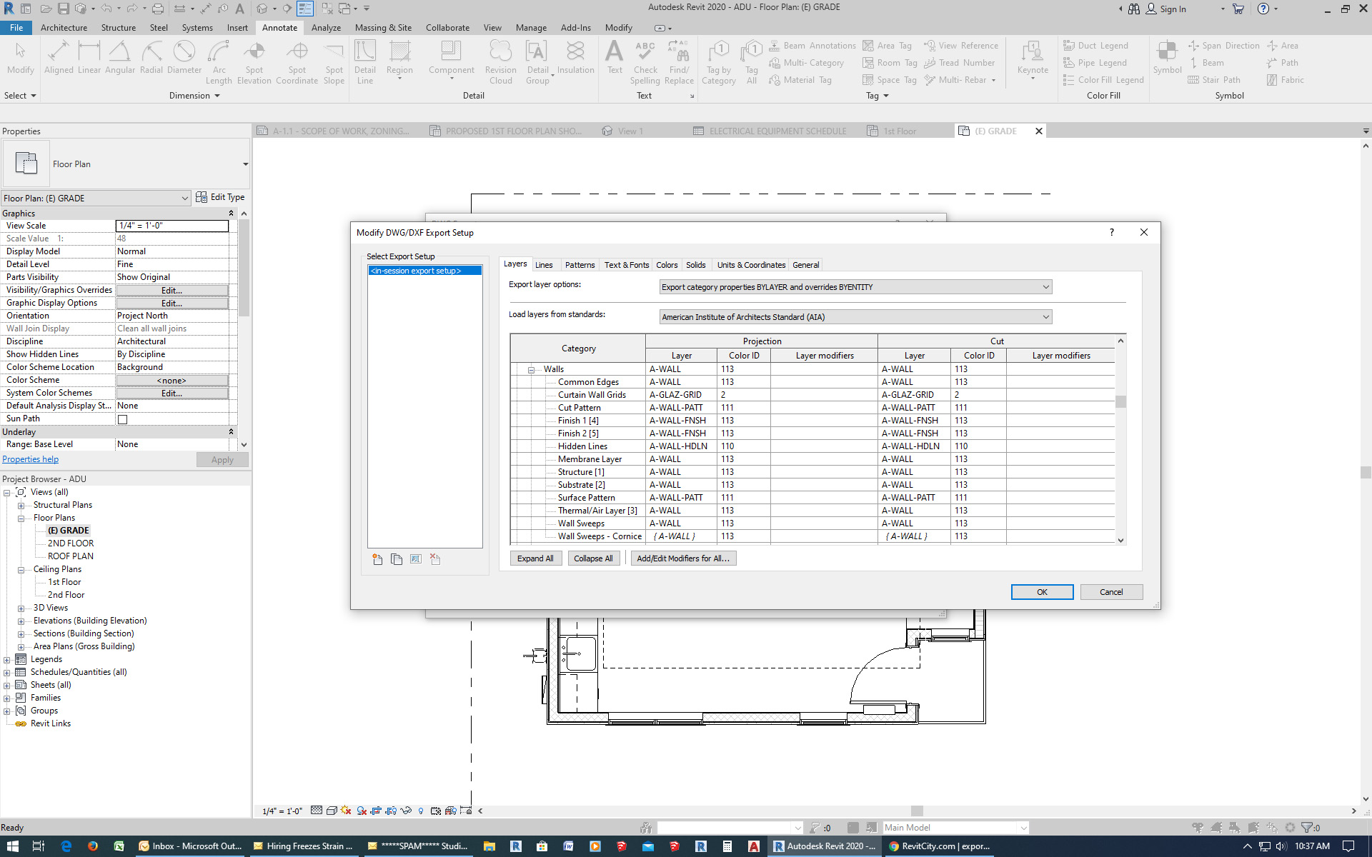

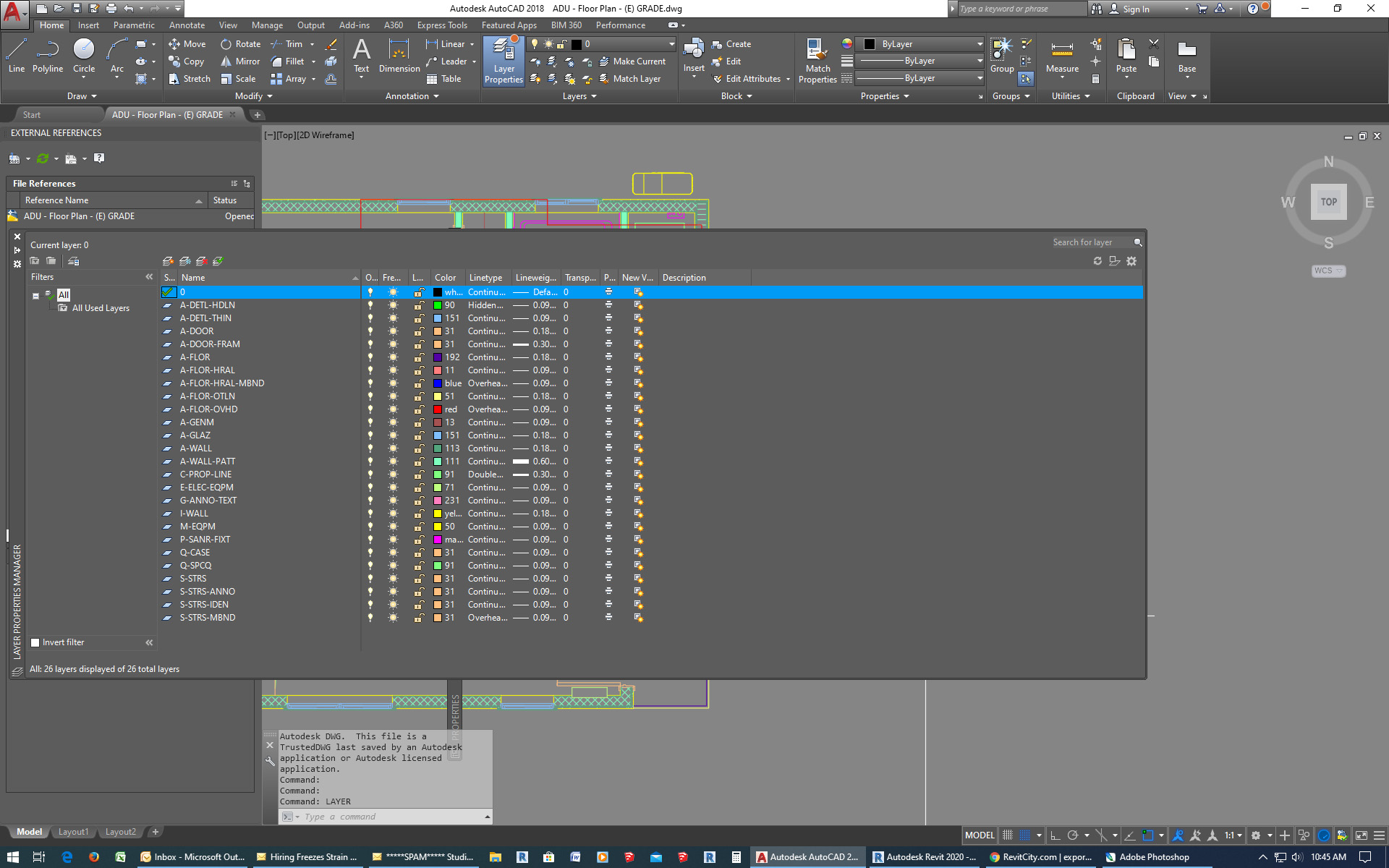

Hello,
See attached snapshot imags, one from revit export layers and the other showing layers from the CAD exported file.
Teh revit settings do nto seem to be translated correctly durign th exporting process. Thank you.

I tried to do it myself. I also have not correctly divided into layers. Maybe a bug?
