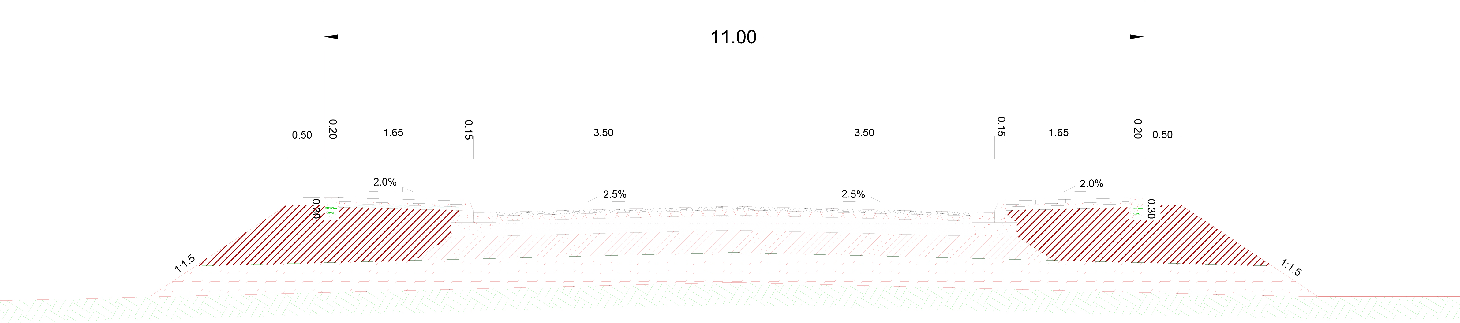

Hello everyone,
I have no idea if this topic has already been highlighted. If so please link to another thread.
I have a big scale master plan drawing on CAD with various sections of roads in different dimensions, such us ( 11m, 12,80m, 22m , etc etc ). So I went through and I imported the CAD in my revit project. Then I created the toposurface from the imported cad file.
What I want to do is to work on the toposurface (since the roads have different elevations) , and create in detail all the sections of the roads and show the carriageway, the curb, the gutler, the sidewalk, the shoulder  etc.
I would really appreciate your help . My site is really huge and I want to be sure that I won’t make any mistakes and that it works correctly.
I am working on Revit 2020 , Windows 10 Pro , 64 Bit
Thank you,
Christos

Revit is NOT a civil program and is very hard to do what you want.  You can cut a topo section and then add 2D detailing but even that is cumberson.
