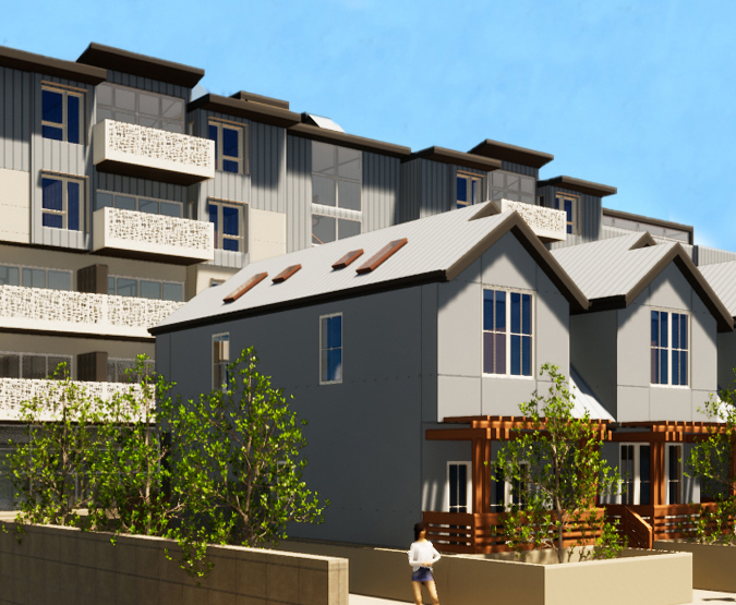

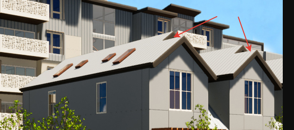

Hello,
We are modeling a standing seam metal roof that will have  the vertical seams continue into the eave. This will appear in the Revit model and the rendered view. How can I make this adjustment in the model material? The finish that is applied does not appear at eaves or rake. See attached.
Thank you.

Tue, May 5, 2020 at 9:05:10 AM | Roof finish to turn at eaves, rake and fascia
marmiketin1
Joined: Wed, Aug 19, 2015
0 Posts
4.5 Stars: 10 Votes
If I am understanding correctly you are wanting the metal roof to go down the fascia? You can accomplish this by going to Modify Tab -> Geometry -> Paint and select the material you want and then paint the edges of the roof. You can then align the patterns how you need.

Yes I want the roof finish in rendered image to go down the eave edge, rake and soffit. So it appears as one continuus finish. CAn I use the paint command for renderings? My rendered image of the roof is a jpeg file. Thank you.

Great thank you, it worked!

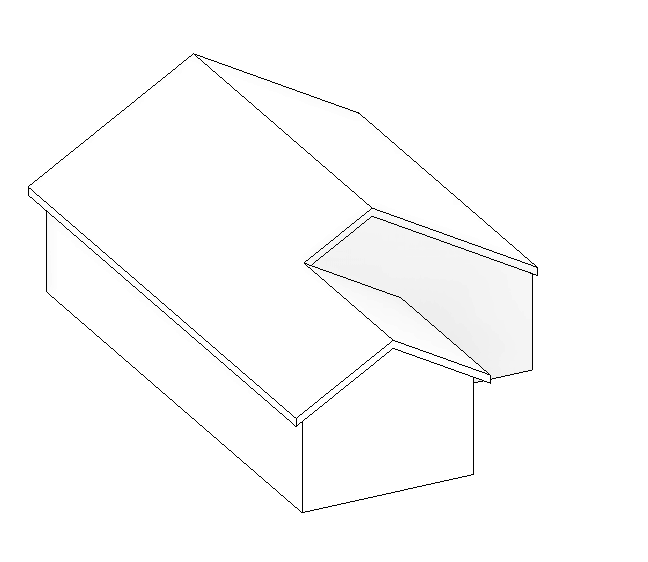

Wed, May 6, 2020 at 6:02:07 AM | Roof finish to turn at eaves, rake and fascia
oskokos
Joined: Sat, Aug 17, 2019
0 Posts
5 Stars: 1 Votes
- Architecture - roof - roof by footprint
Check Defines Roof Slope like on a picture
Enjoy Smile
