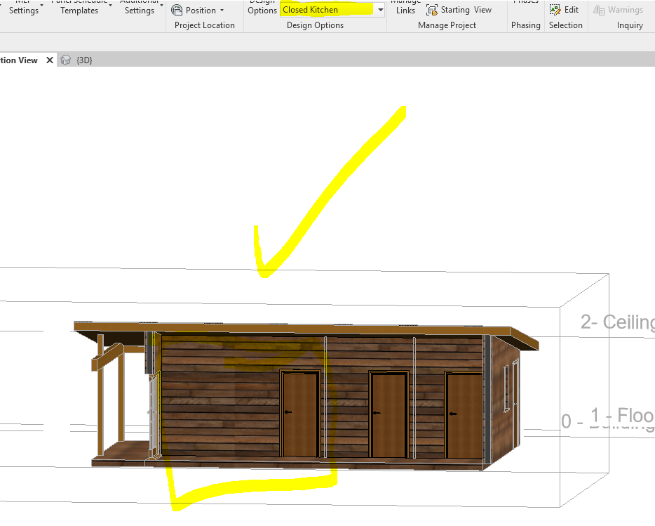

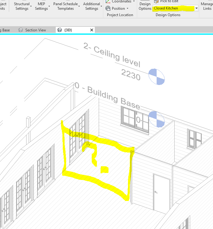

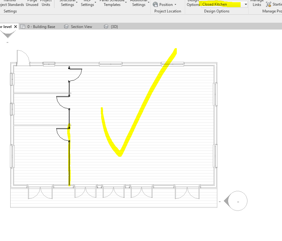

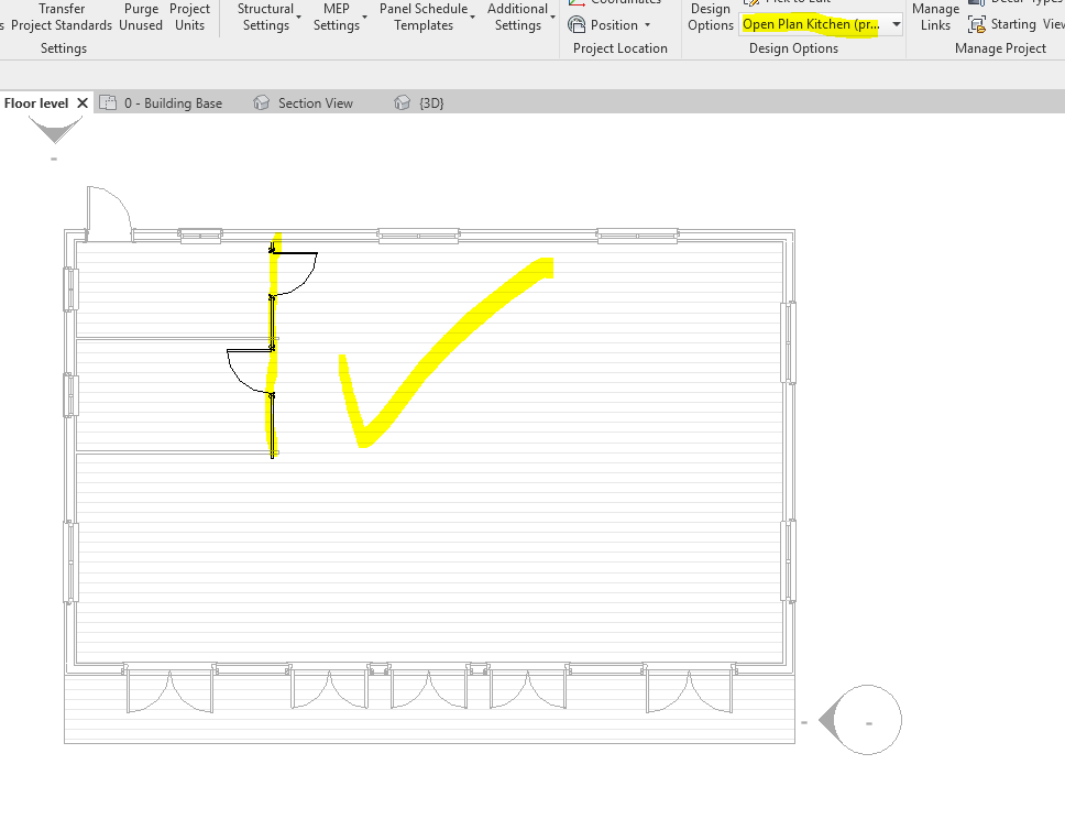

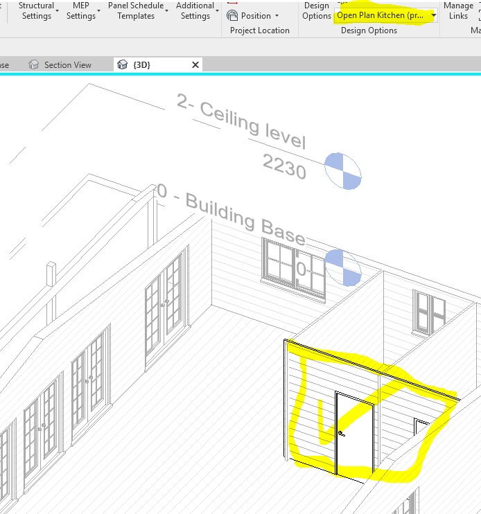

Hello All,In the first instance, thank you for taking time to read my post, I really appreciate it. I am new to Revit so my issue is likely inexperience I would guess rather than program bug.I am using Revit 2019Basically I am drawing two options for a kitchen layout, one open plan, the other a standard room, so have configured 'design options'. Basically one option with the wall to enclose the kitchen, and one without. In all views except the standard 3d view, the wall appears and disappears on selecting the design option as intended.Its left me baffled, so any advice would be gratefully received, thanksAdrian

Look at your option settings for the first plan view you show then look at them for that last 3D view.  If you need more help, you have to show us these settings.

Many thanks for reading my problem, and taking time to reply, I really appreciate it.
I think within Visibility Graphics, for the 3d view, under 'Design Options' rather than sitting on 'automatic' it was linked to option view, (primary) so changing the Design option didn't effect the 3d view, as it got 'hardwire' to a option. It could well be 3d views are more 'static' in this regard anyway, but default? Not sure..
I simply fixed it back to 'automatic' and the options now display as I would like within the 3d view.Edited on: Mon, May 4, 2020 at 6:58:49 AM
