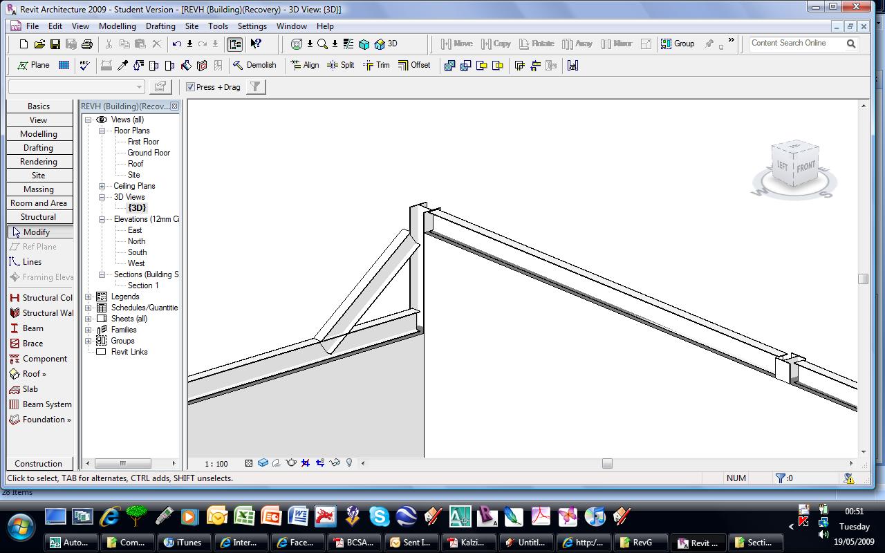

Hi
 Does any one have a solution to previous question, I would like to have the sloping steel which is shown connecting to the beam and the column, can this be cut in any way... I am am using Revit 2009, Cheers

Cut the beam with a reference plane should work, see link
http://www.augi.com/publications/hotnews.asp?page=899

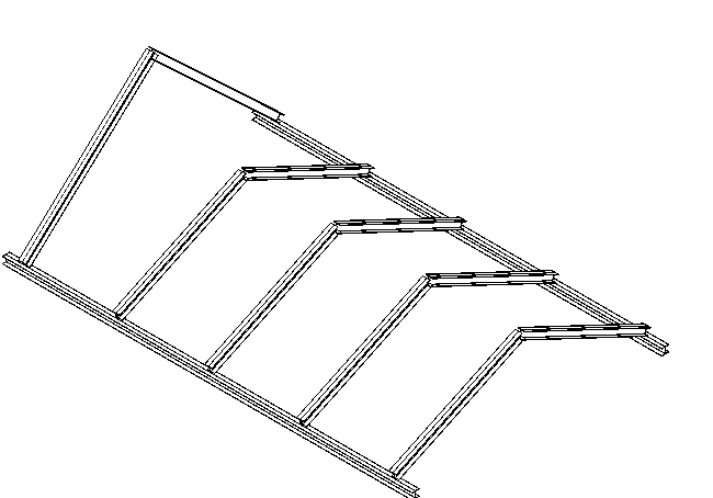

The slope of your beam can be determined by the parameters Start level offset and end level offset.
I would like to know how to "trim" sloped beams  that are in a vertical plane.
Eveline
Thu, Apr 8, 2010 at 12:44:00 PM | sloped steel?
my68spit
Joined: Wed, Feb 24, 2010
3 Posts
Eveline,
I am not sure what you are asking.  Which of the member sin the attached image are you trying to "trim"?  Are you wanting to modify the whay that they are joining together at the ridge?  Or you want to trim them on a vertical plane at the horizontal members?
Thu, Apr 8, 2010 at 2:24:46 PM | sloped steel?
eveline
Joined: Sat, Feb 11, 2006
29 Posts
Both, I want to control the way the beams are joined at the top of the roof and the way they connect to the horizontal beam.
