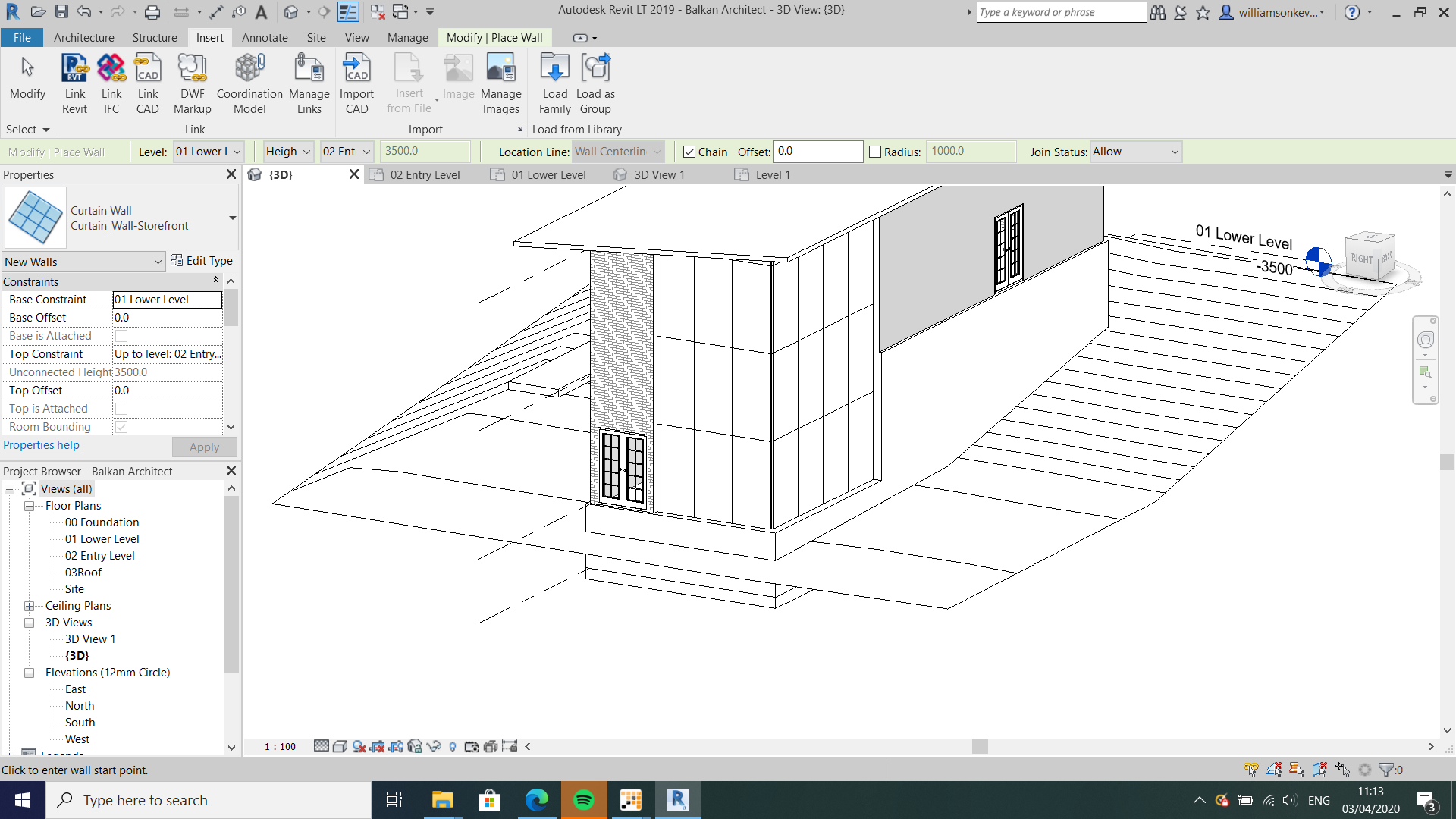

Hi, I'm new to revit and i am running Revit LT, i have been following the trianing course on u tube by the Balkan Architect. i have added a curtain wall shopfront to my model, the problem is that it does not look at all like the one on the training video, it is not transparent and not showing anything trough the glass in 3d, also the transomes and mullions of the curtain wall are not showing. would this be caused because i am using LT. any help would be appreciated.

What tutorial are you watching? Link and a specific time on the video will be helpful. Also, could you upload your file, or at least screenshots?
It is not because of LT.

Hi, thanks for your advice please find information requested. The video by the Balkan Architect is 'Quickest Fastest Revit 2019 Beginers Course Part 5. and 12.13 minutes into the video.

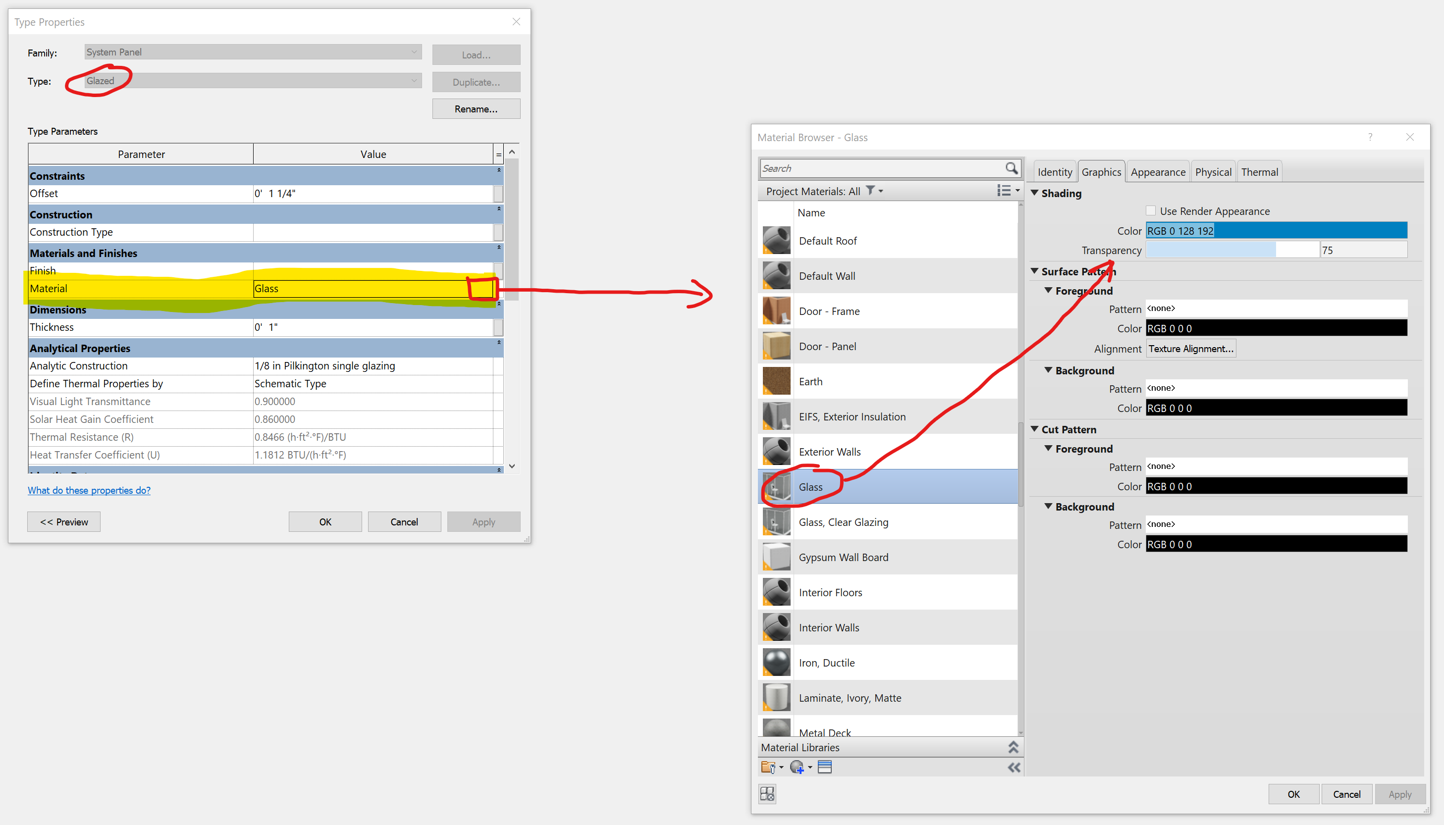

Fri, Apr 3, 2020 at 2:42:51 PM | Curtain wall shop front
pijpiwo
pijpiwo Avatar
Joined: Fri, Sep 3, 2010
0 Posts
5 Stars: 25 Votes
Hover your cursor over the edge of any panel and tab until it highlights. Click on it and check the material that is assigned to it – see pic.
