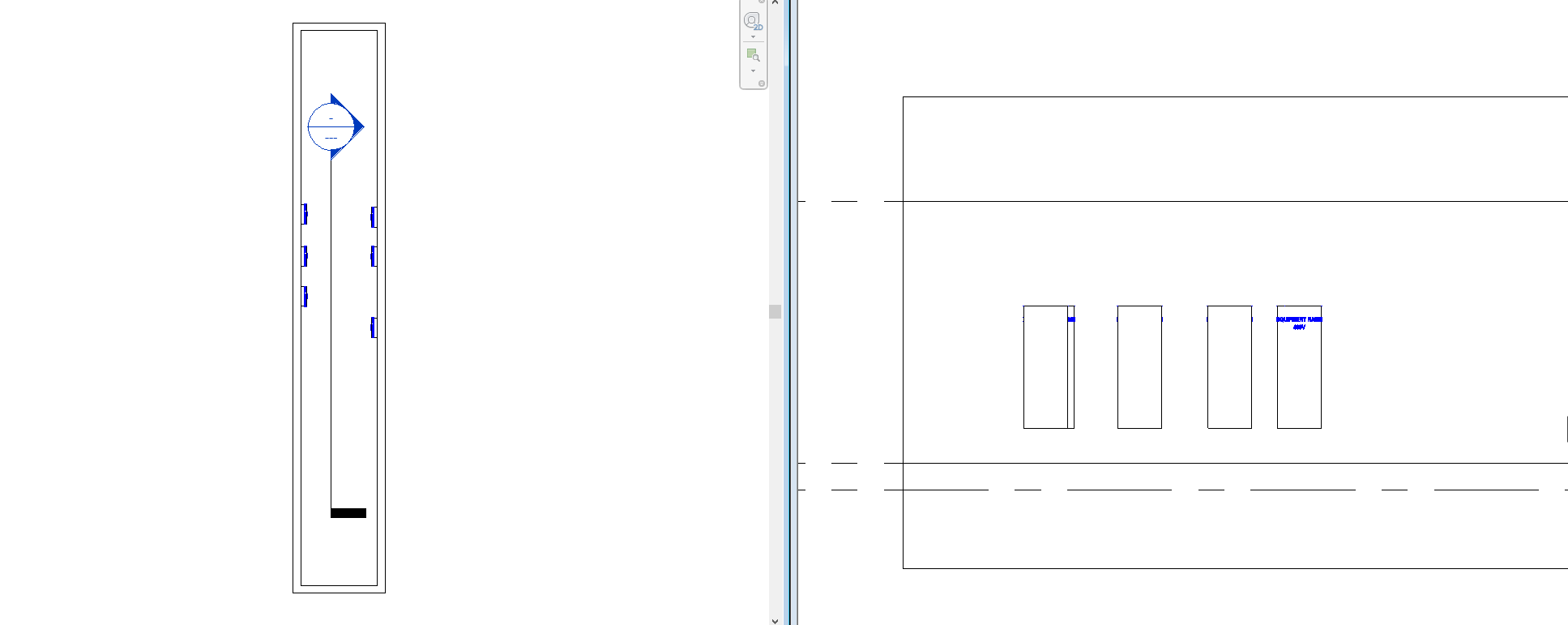

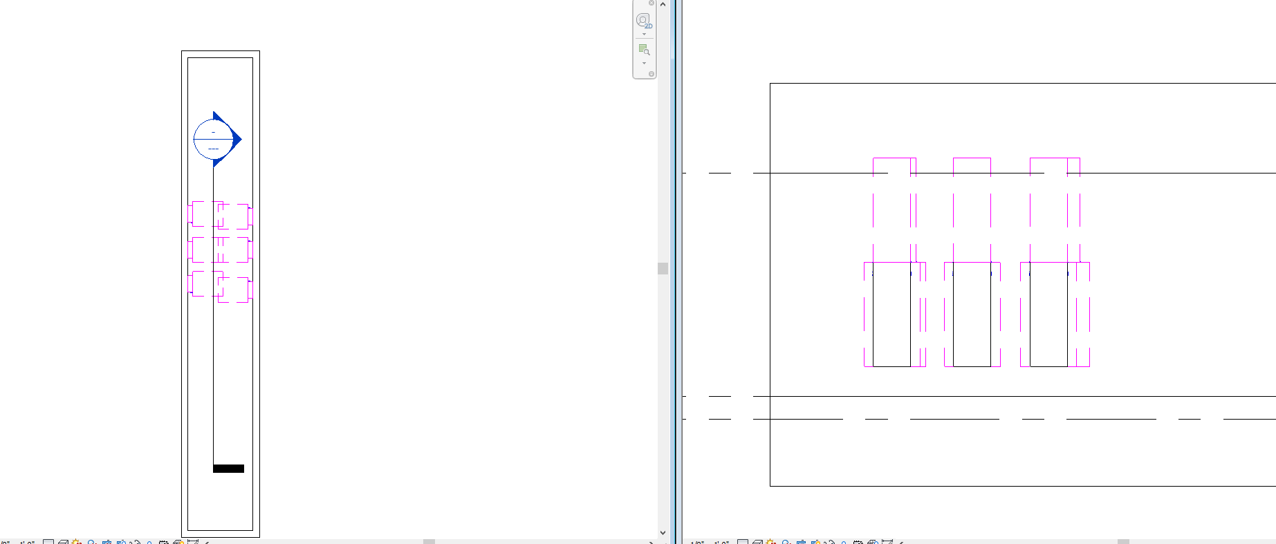

Hello,
I am trying to show a section view of a wall filled with panels and only those panels. Although the panels on the other wall show because the clearance crosses the view section line. Even though I turn the clearance zone off in the VG. Is there a way to fix this? In one of the images you can see the clearance is crossing the view. In the other picture you can see the clearance is off although still isn't turning off in the section. Thanks
Wed, Mar 4, 2020 at 4:06:02 PM | Having visibility issues in view section
First, that doesn't appear to be a section view of a wall, it looks like a section used to show the elevation of a wall.
Move your section line.  If you don't want the head to move, split the section line and move the split.
