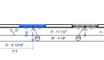

The marks in the window schedule do not appear correctly in the tags on the floor plan.
I'm using Revit 2020LT.

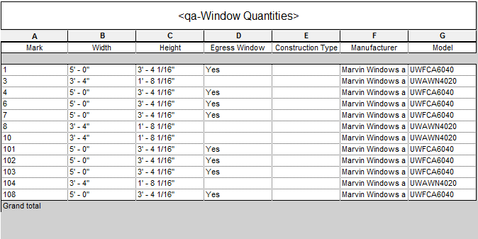

Open your schedule, then got to Properties --> Fields --> Edit and make sure your first field is referencing MARK and not TYPE MARK. Since your sencond image shows the two windows both having the same value I will assume that currently it is referencing the TYPE MARK which is a type parameter whereas MARK is and instance parameter.

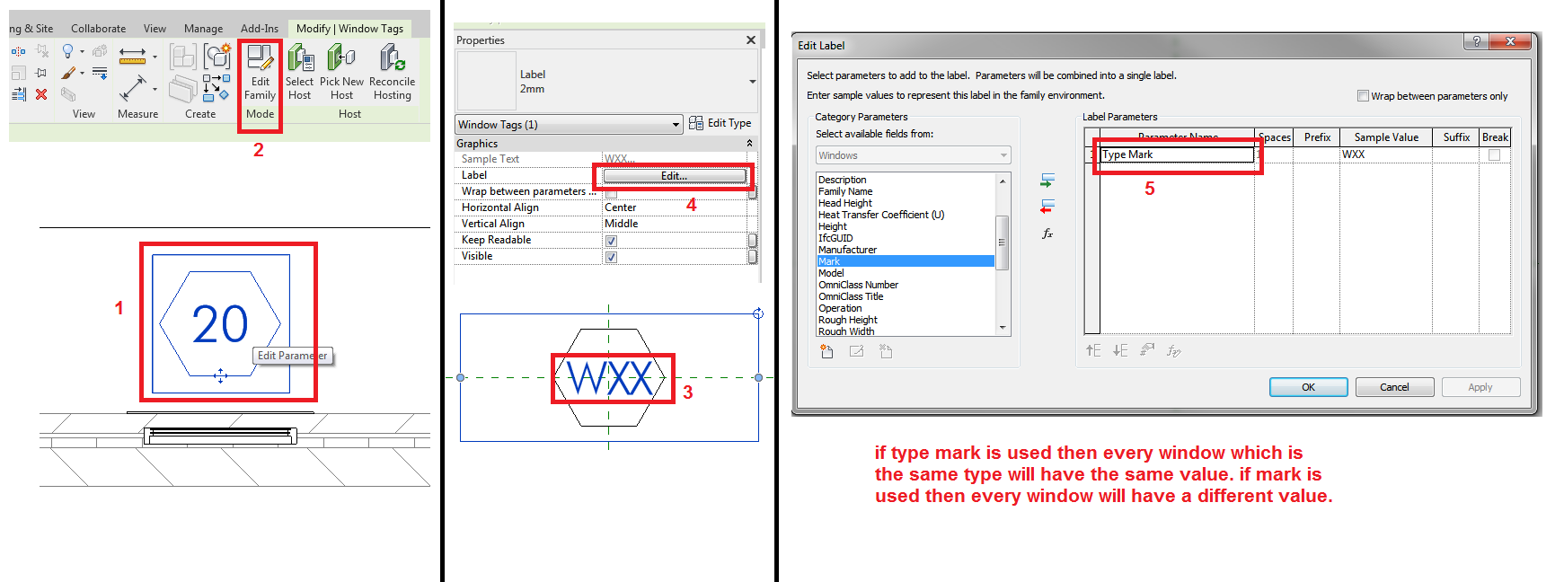

If that is not the case then it might be your tag is referencing the TYPE MARK and needs to be changed to MARK. You need to do this in the family editor and select the label and change its properties.

I can select a tag, then mode, then famitly editor. I get a picture of the tag but no dialog to change parameters.

See attached image for process to change window tag associated parameter
