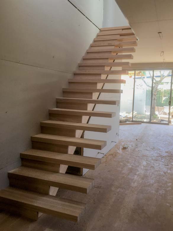

anyone knows how to create the stair riser to be only half with of a flight. I want to create half of the stair open and half with closed risers.
refer to picture attached
thanks

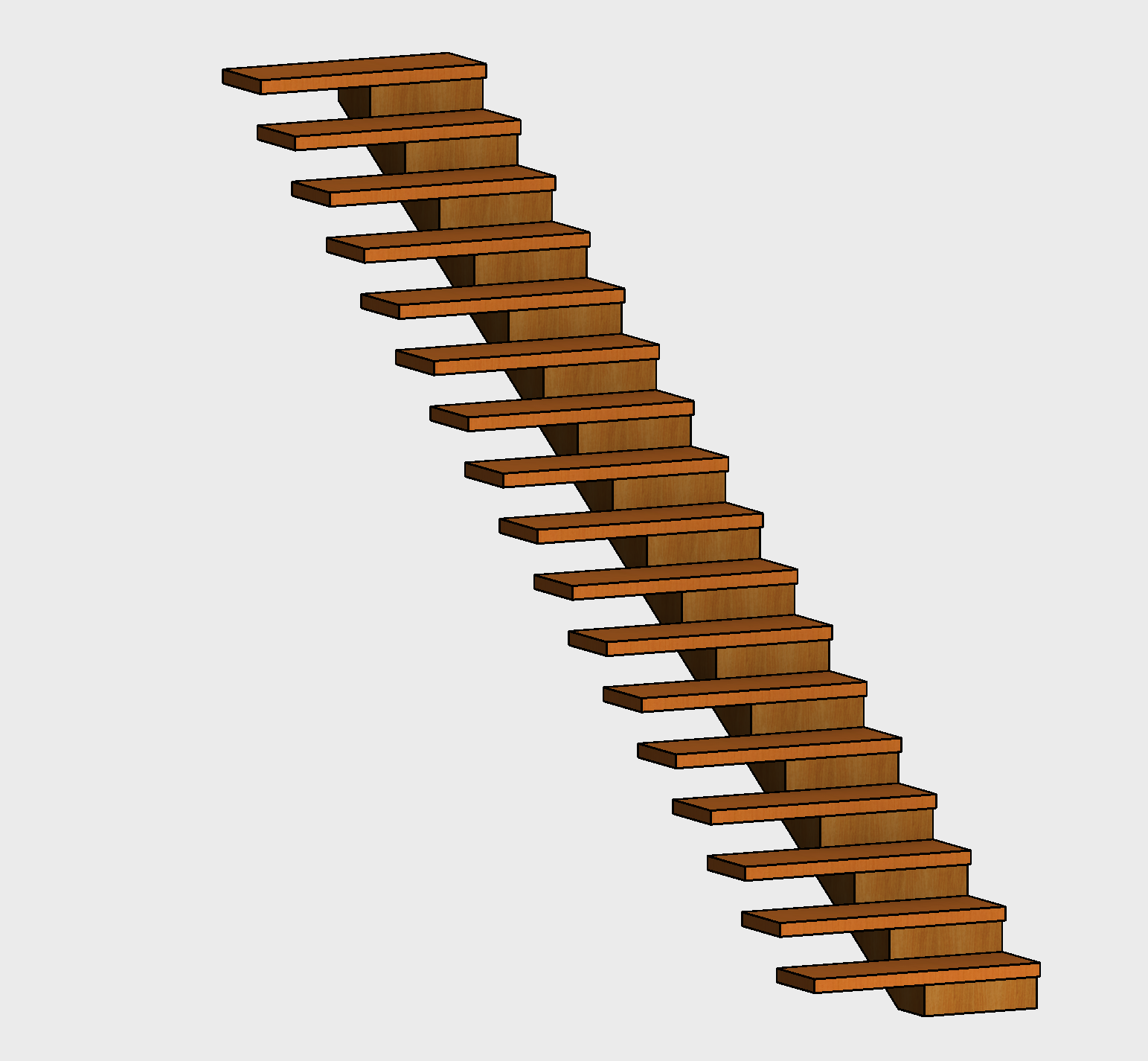

Adjust the stringer thickness.

thank you so much pijpiwo, how didn't i think about it before Smile\
