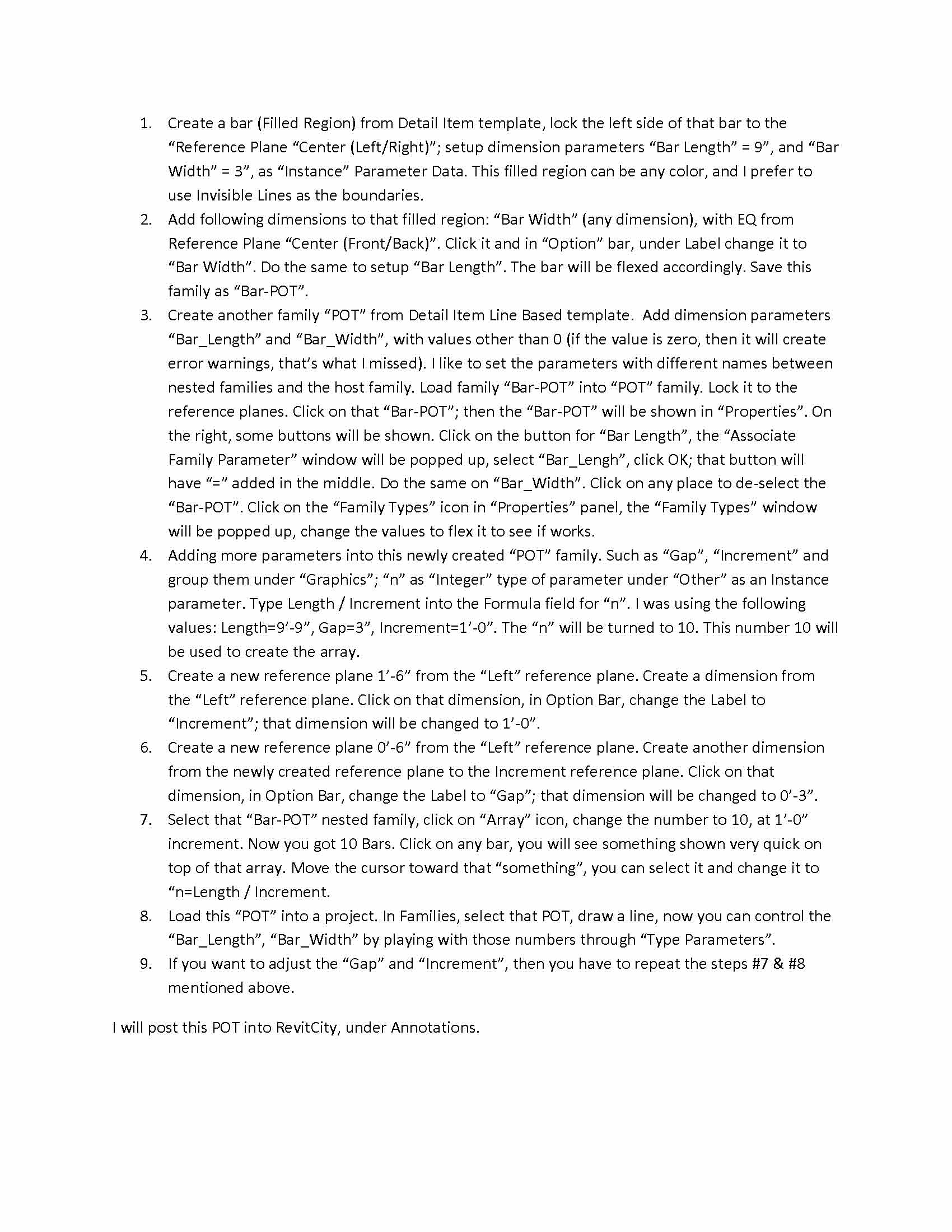

If you are just try to create a line based pattern, you may try the attached step-by-step tip.
Try this link to download the family file.
https://www.revitcity.com/downloads.php?action=downloadnow&object_id=18185&object_file_type=rfa

Thanks CDWdavid for the detailed description. There is plenty of useful information there.
I am really looking for a fill pattern / .pat type solution, if that is possible. I did come fairly close but didn't succeed.
Any help in that area would be appreciated. Thanks.

Hi Penandink,
Have you tried to download that POT, and place on a drawing? The only different would be that you can add a thin lines on both sides, and change the color to dark green. Revit is different from the AutoCAD, the Revit thick lines are all have round corners.
Edited on: Thu, Jan 2, 2020 at 3:23:15 PM

Hi CDWdavid,
I did download your annotation family, re-color it and have used it, and it is a solution.
However, it would be preferable if I could find a solution via a fill pattern, as it would allow continued use of the actual cable trays, which would be more flexible.
Thanks for your help and quick response.
