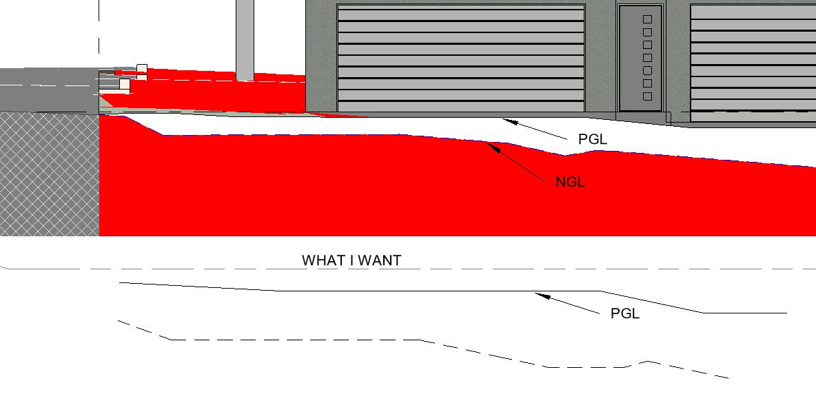

I am trying to display topology natural ground level and proposed ground level lines in both elevation and cut views. I want to only see one line for existing surface and one line for the proposed surface without any projection lines and fill. Can anyone tell me if it is at all possible in Revit. I have tried playing with settings for phases but it does not seem to help for existing surface that is nominated as new construction in phase demolished. I have attached picture showing what I have and what I want.
I have tried searching all over internet but have not been able to find a solution. Any help would be appreciated.
In the picture
NGL- Natural Ground Line
PGL - Proposed Ground Line

When u grade a topo you get 2 topo surfaces, name each one (different of course) so u can turn them on and off

I have already created two surfaces and can turn then on and off. The question that I am trying to answer is how to precisely control the display of cut and projection lines.
