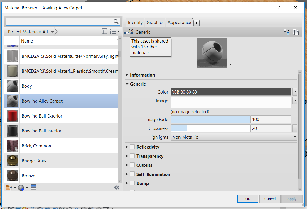

Is there a way to make these materials stop sharing an asset? It's getting on my nerves.

Create an asset with it's own name instead of generic.
(Under the information drop down)

Thanks man
