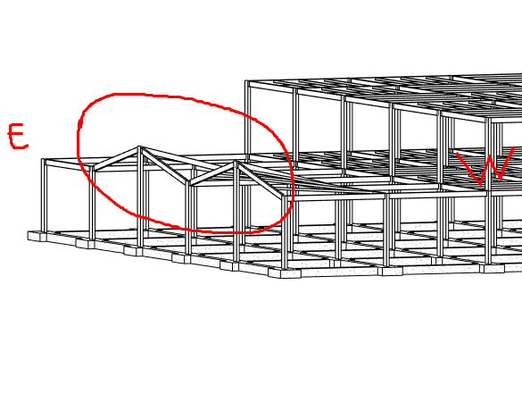

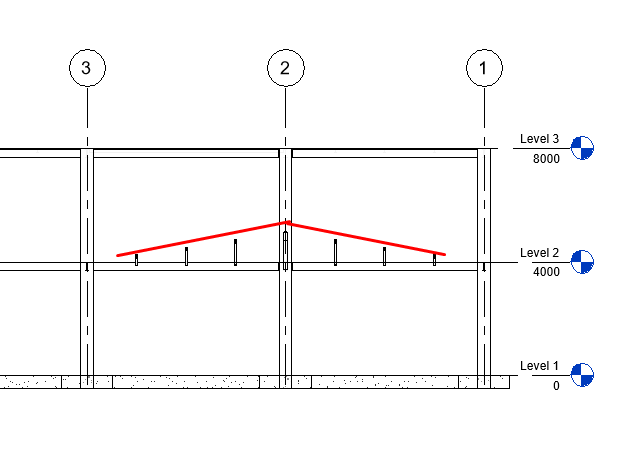

Some of my beams (the red lines i drew) don't appear from "West Elevation" look. And visibility is set as "Fine". Do you have any idea what may cause that ?
Mon, Oct 14, 2019 at 10:17:47 AM | Some beams don't appear from one side.
MehmetCad
Joined: Sun, Sep 29, 2019
0 Posts
Ops, i mean from "East Elevation"

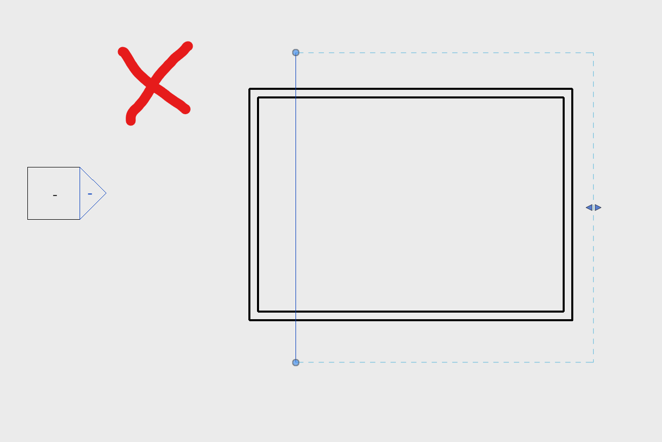

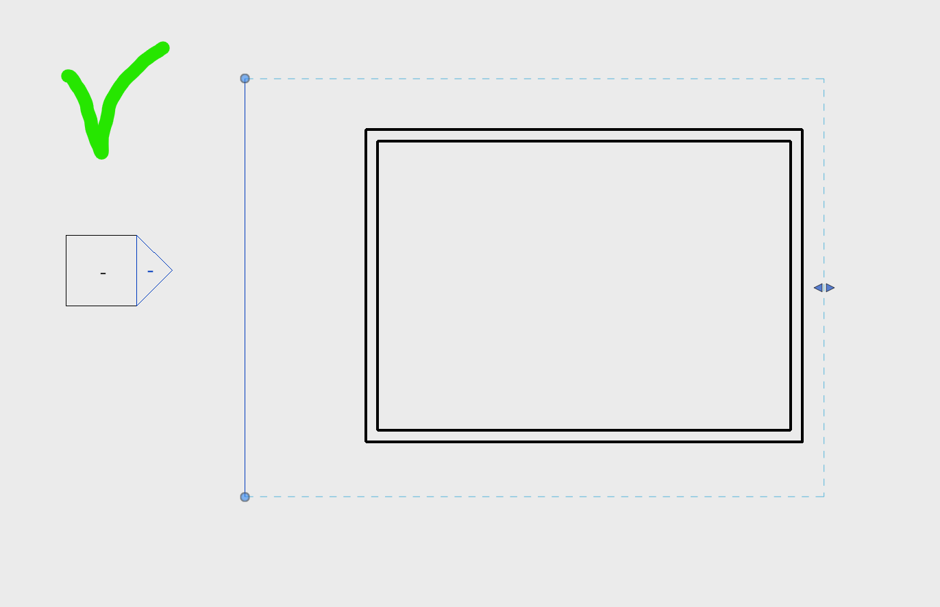

Make sure elevation cut line is in font of your building, not cutting through it.
Mon, Oct 14, 2019 at 12:50:59 PM | Some beams don't appear from one side.
MehmetCad
0 Posts
Oh, yes it fixed the problem. Thank you. Are there cut options for floors, too ?
