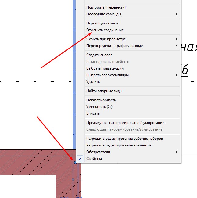

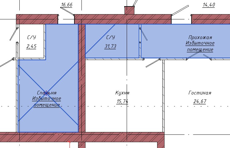

Hi! I am placing rooms and tags on my plan and some of the rooms boundaries appear wrongly. It looks like the boundary does not see the wall and takes the next room's area too. Any thoughts? Revit 2019
Sat, Sep 21, 2019 at 6:57:01 AM | Room boundary issue
Look at the wall properties, is room bounding turned off?
Does the wall go to the level the room is placed on?

All is fine, the room bounding is on. What I did is I allowed the wall connection (intersection) which is not good but at least room boundaries work. After I place the finishing I will have to break the wall connections again. But for the moment I solved the issue (probably not the best solution). Thanks.
