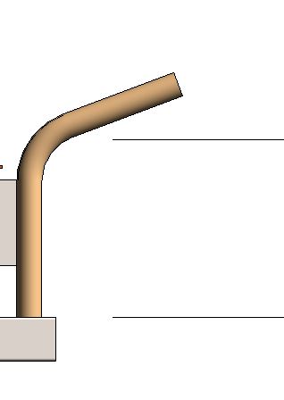

I would like to draw a circular tube column with a bend at 30 deg as shown in the attached picture. I tried as a sweep function creating a generic model but when it comes to dimension it, I can not dimension the generic model. Is there any solution or a different way to draw. Your help will be much appreciated.

try open new family column project and try crating it by there and try loading it as a family in ur project..

You may use “invisible lines” in that generic model to create all snapping points for dimensioning purpose.
