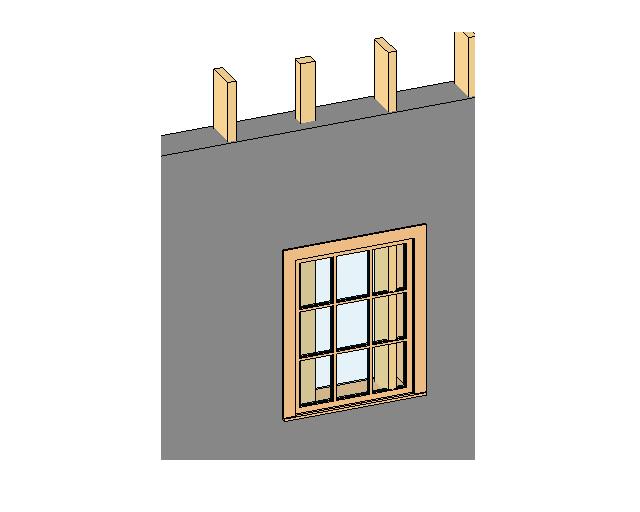

Hi, Was playing alittle with the structual tools. Can I make my windows cut through structual columns and walls? (See attatched file) Or do I have to have two columns, one below and one above? /Jocke

Not that I am aware, as it would be normal to cut the columns and introduce a trimmer which must be done manually unless any1 knows of a way to cut structural objects
