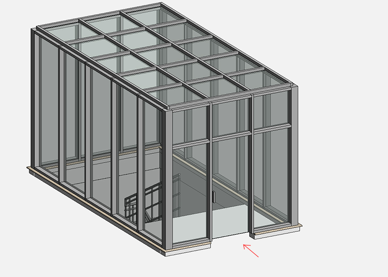

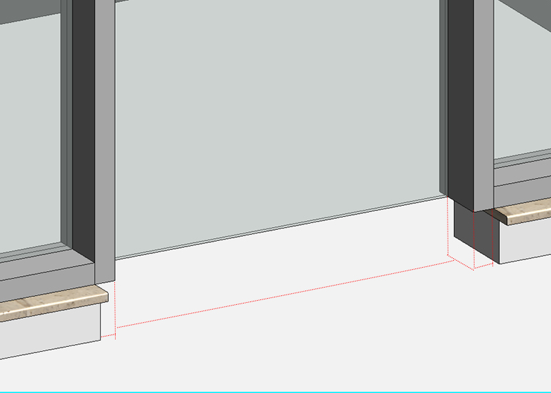

HiI have a glass terrace exit with heightened curtain walls from the floor . (Attached) So on the ground I have a wall with a marble sweep. And on top of that I have storefront curtain walls. The door should go all the way down but since it is a curtain wall panel it doesnt, leaving a gap. I need the mullions surrounding the door to go down to the floor. How do I extend the mullions and panel inbetween down to the floor ?Any help is appreciated. Thank you

Edit CW profile.

Wow I am such an idiot. Thanks man. Works like a charm.
