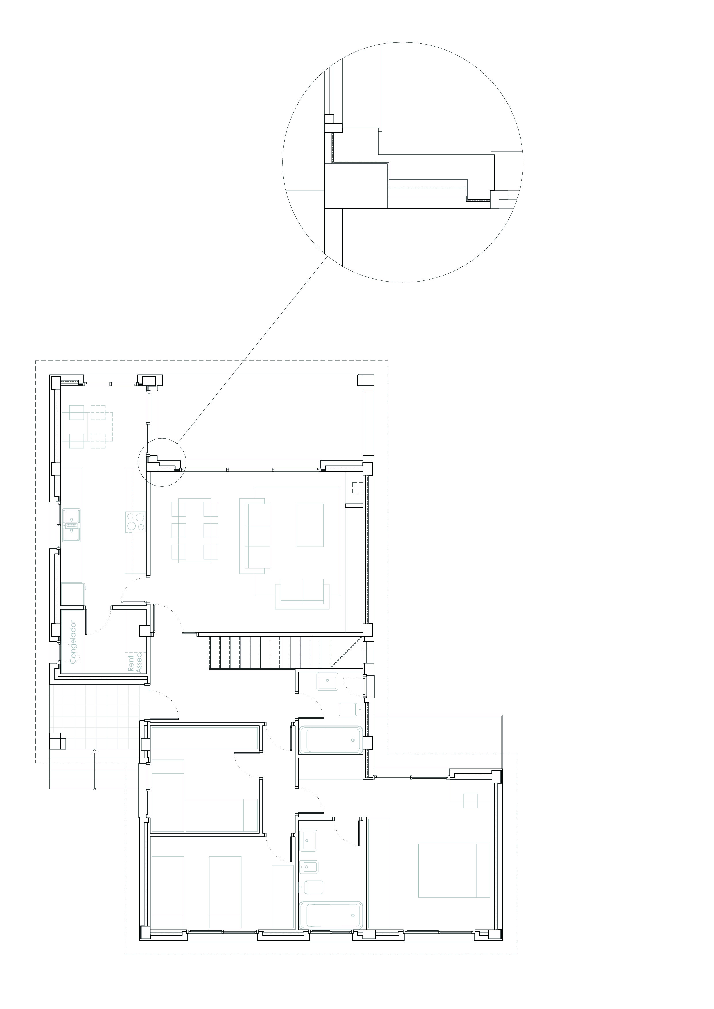

Tue, Feb 3, 2009 at 11:06:47 AM | openings in walls
azimuth
Joined: Mon, Feb 2, 2009
2 Posts
Ok....
This is the problem... could you solve it? (In Revit... lol)
The wall is made in: Brick (Ext) + Air + Termical Isolation + Ceramical Tile (7cm - Interior)
The encounter with the pier is made in: Bat Brick (Ext) + Tecnotermical Sheet (1 cm - Really 2mm) + Concrete Pier (Int)
 Thanks...
