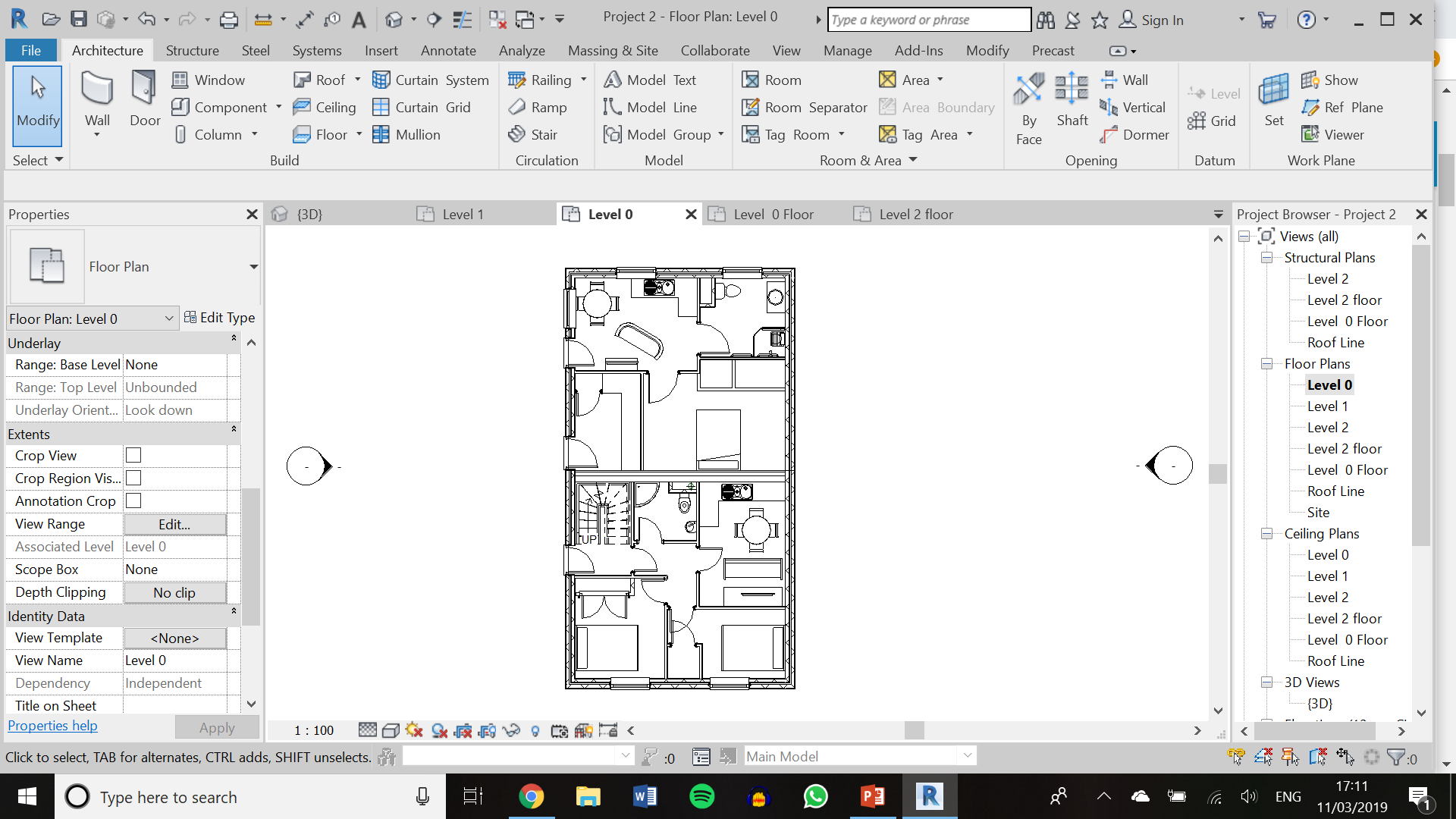

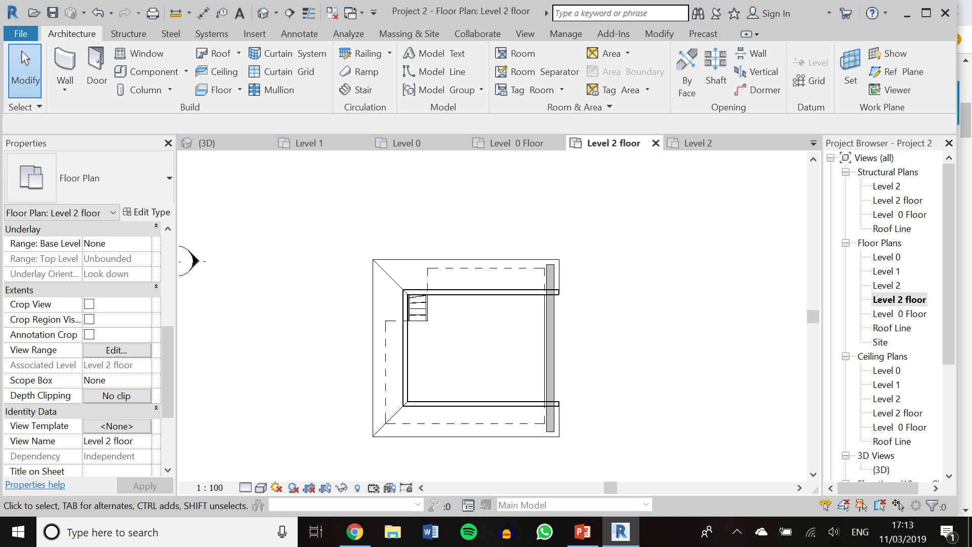

Can't view walls on second floor - I have the limits set to the correct floor but are not showing on the floor plan.
Any help would be much appreciated!

If th floor plan is set to the discipline Structural it will not show non structural (architectural) walls. Just something to check.
