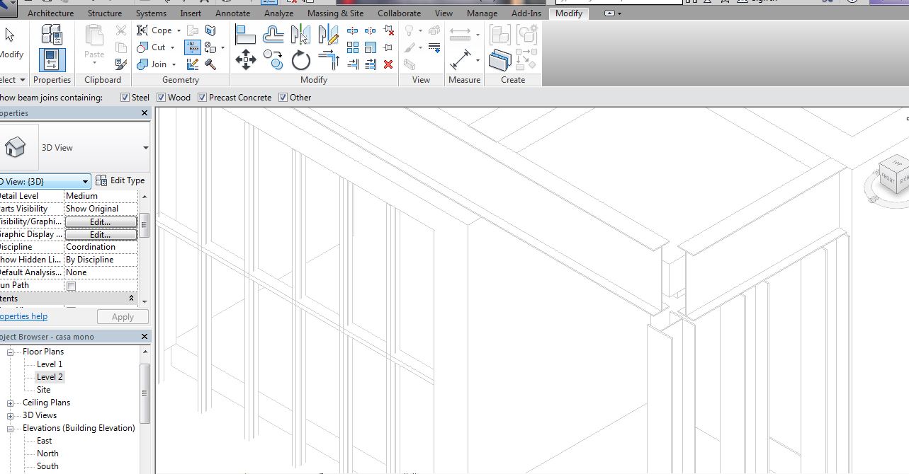

so i go to modify > geometry > beam columns joins and then the screens turns white in 3D and i cant finish the process. and in floor plans i cant see the beams! and same thing, im not allowed to do the operation of joining beams to columns. idk what the problem is. I'll attach a capture of what the white screen looks like in 3D

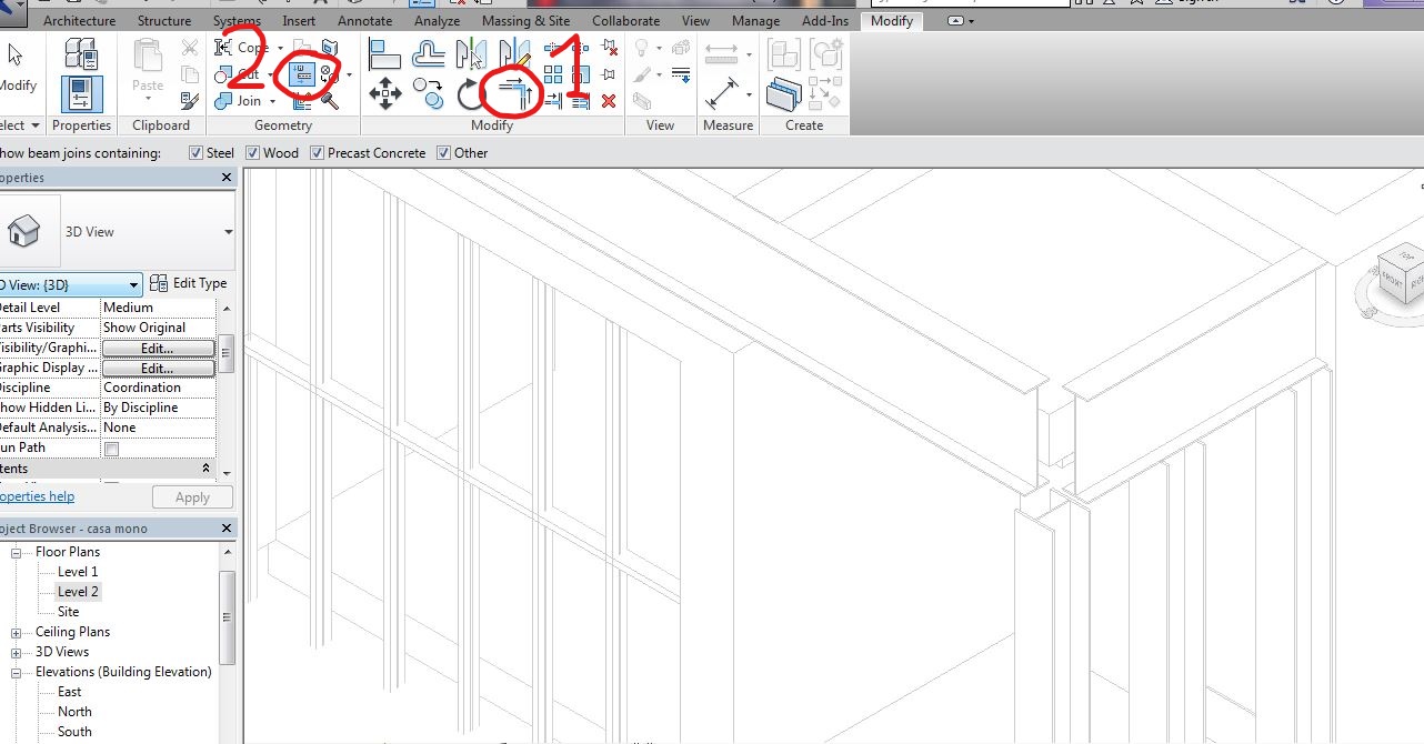

Probably it doesn’t work because the beams are not joined. Use Trim/Extend tool first and then Beam/Column join tool as needed.
