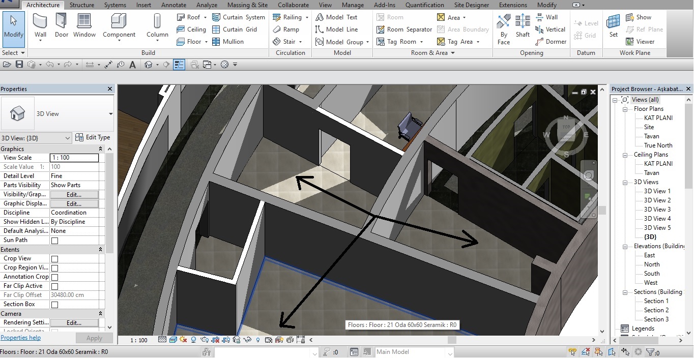

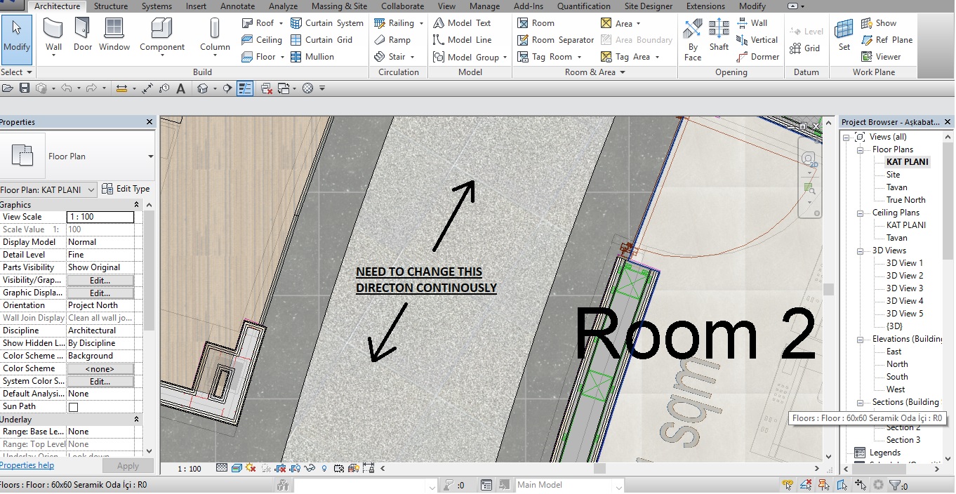

Hi everyone, I have 2 big problems.
1) When I use same material in different rooms for floor covering, change in the direction of floor covering in one room effects the other rooms, eventhough they are created seperately and named differently for each room.( 1st and 2nd picture)

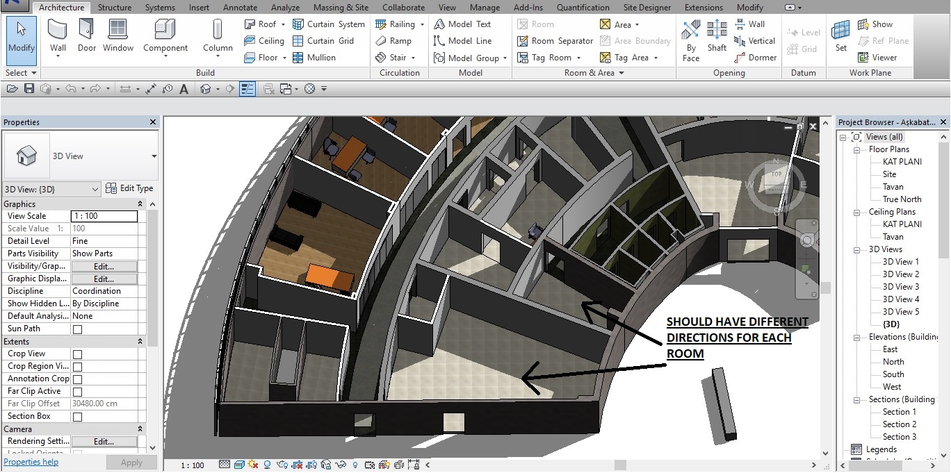

2) The building I'm working on has an ellipse form, so the corridor in the center must have an angled joint direction varying from start to finish. How will I change it? In autocad I could do it with array command but in Revit I couldn't figure it out (3rd picture)

Read you help on the different types of hatch patterns - drafting vs model.

Wed, Feb 20, 2019 at 1:45:34 PM | Floor material angle problem
My answer was for your question #1.  Your floor material should be defined using a model pattern.  That can be rotated independetly.
Question 2 - You can't do this with normal fill patterns.
