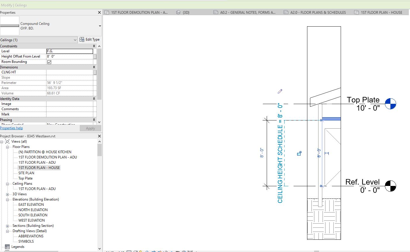

i've read all kinds of articles about adding ceiling heights to room schedules.  Most say to use a formula of volume/ area, but I still cannot get that in my schedule and I'm not sure if volume is to the ceiling or to the top plate or how its measured.
Here's my real question:
When I click on my ceiling, the properties gives me "height above level" and which level you want it to read from.  How can I associate "height above level" with rooms so I can use that in my room finish schedule?

I am not fond of the calculated ceiling height.
I found this but i'm not sure if it is applicable.
https://revitpure.com/blog/how-to-show-ceiling-height-in-a-room-tag
