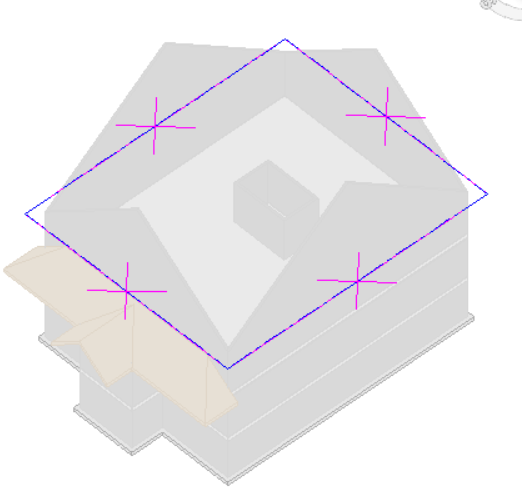

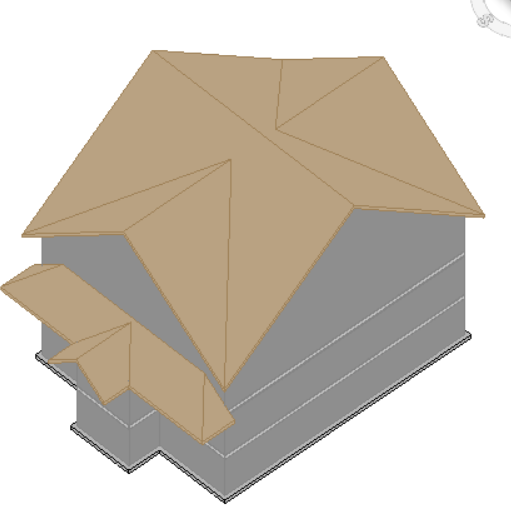

To make the roof attached in a single sketch draw a rectangle, split each segment in the middle and add slope arrows as shown. Works best with all roof surfaces at the same slope. Use 'slope' to define the slope arrow not 'head and tail offsets'.
