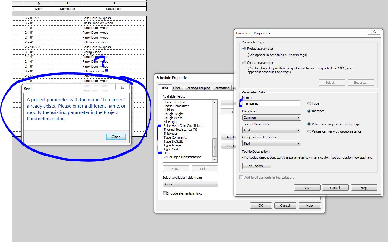

I want to add a "tempered" field to the scheduule. tells me that there is already a "tempered" in the list of parameter choices. But there isn't nor will it let me make the parameter from scratch. not sure how to deal with that. see pic. note the list doesn't show a temered parameter choice...same for both my wall schedule and door shcedule. Worked on my window schedule tho...

Usually door parameters are shared parameters, they are different from the family parameters.
In Revit, all parameter names are case sensitive, which means that the “tempered” is not the same as the ”Tempered”.
You can try to rename them and see if that works.

I think you have a Project Parameter already in the model, but it is only assigned to the window category.  If you go in Manage/Project Parameters, you should be able to assign the "Tempered" parameter to the wall and door categories also and then it will be available for those schedules.
