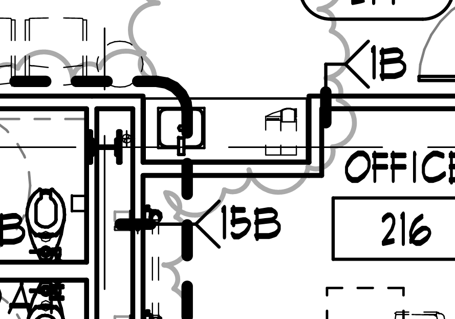

Perhaps I am still not explaining clearly what I want.  I am able to make the clouds half tone, but when the clouds overlap with other objects, the clouds block the information underneath such as text.  Please see the attached pdf file.  I would like to be able to put the cloud behind other objects or have the cloud print transparent so you can see both objects - the cloud and text.

You did complain that halftone did not print and that was what I responded to.
Clouds are always on top so you have to draw them so they do not cover up important information.

Use a print driver that allows line merge.  For Bluebeam under "General Settings" check the "Line Merge" checkbox, select "Advanced", select Blend Mode "Darken", select Opacity "100%".  See results in attached image.
