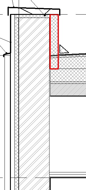

So the basic question is, can i cut roof with wall sweep that is added to wall construcion within type.
Please see attached image. The sweep is long enough to cut where red line is drawn. But it doesn't! Switch join order does nothing.

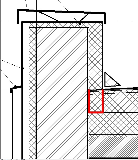

This is sweep in wall structure, from profile.
That screenshot is a bit misleading. Here I attached new screenshot. You can see that the sweep is just in top of the wall - the red line
But it doesnt cut the roof.
Thu, Jan 17, 2019 at 6:47:34 AM | Cut roof with wall sweep when join
The only sweep that I have seen cut anything is a void sweep.
Look again at making this be part of the wall and setting proper priorities.
