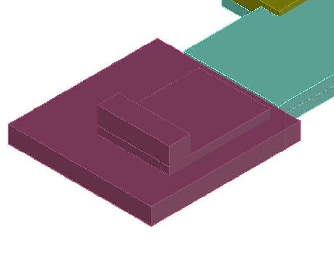

Hello All,
I am currently using revit 2018. I have a model in the SD stage, nothing but massings. I am trying to figure out the best way to get sqft for roofs and exterior walls. Right now the model gives me gross sqft when i click on a massing but i need sqft for the individual surfaces. The process I am using is to select the massing, edit in place, click on a surface then click on divide surface to get the sqft, is there an easier way to get the sqft of the individual surfaces of a massing??
I have attached an image of one of the massings
Thanks in advance,
Danny

Mon, Jan 7, 2019 at 2:35:00 PM | Massing
Use a filled region, it will report area.
