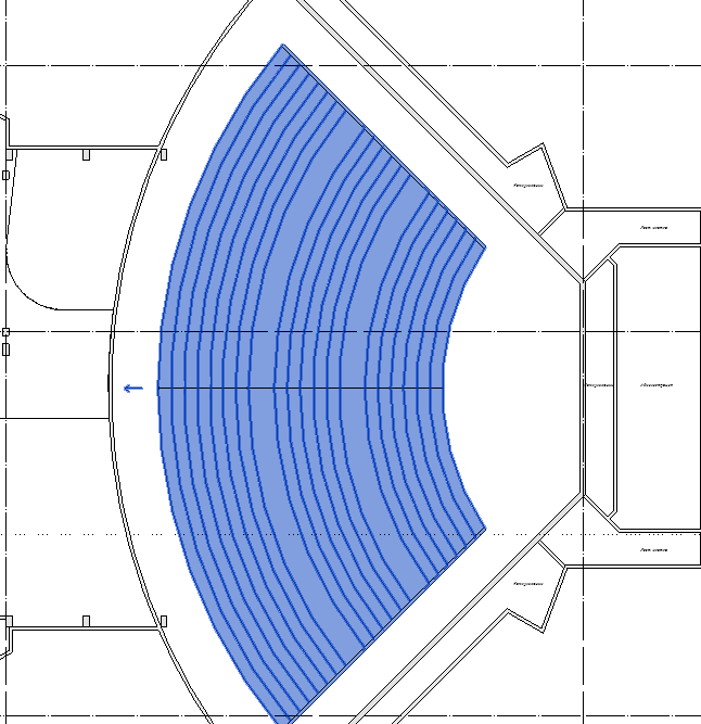

Good day!

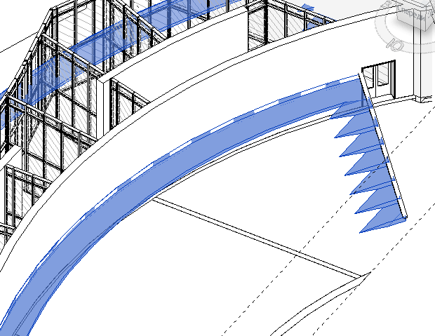

I have created theatre seating rows using stair tool. It shows up fine on plan view while in 3D and section it looks weird. Any advice?
Thu, Dec 20, 2018 at 7:44:34 AM | Theatre seating using stairs visibility problems
Yes, there is something very wrong there but I have no solutions.  The portion shown beyond the wall in your perspective that should not be there says something is very corrupted.
I would never use stairs for this.  Much easier to use slabs and walls which is what I have always done.  Easier to adjust and the slabs will host the seating.

I bet that your stair is monolitic...Select that stair, go to Type Properties and under Construction -> Underside Surface choose Stepped (and Apply)You see the difference?
