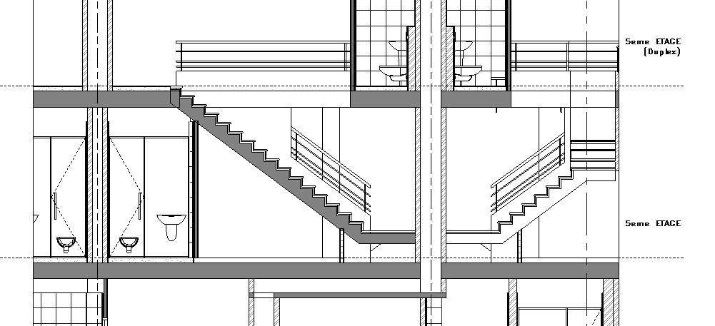

Have section for stairs, same type and material,
but it appearing in section def.
as shown in attchment,
anyone know the reason for that...!?

Explain what you think is wrong.

no cut pattern  in stair on the right side...
Thu, Dec 13, 2018 at 8:20:45 AM | Stair Sections
Are both stairs in the same phase?
Cut another section and see how it looks.  That could reveal any possible over-rides.

  figured out, when  i  makes edit for component stair  and converted to sketch stair, with strange treads design,
revit accepted, but it came out of box...
