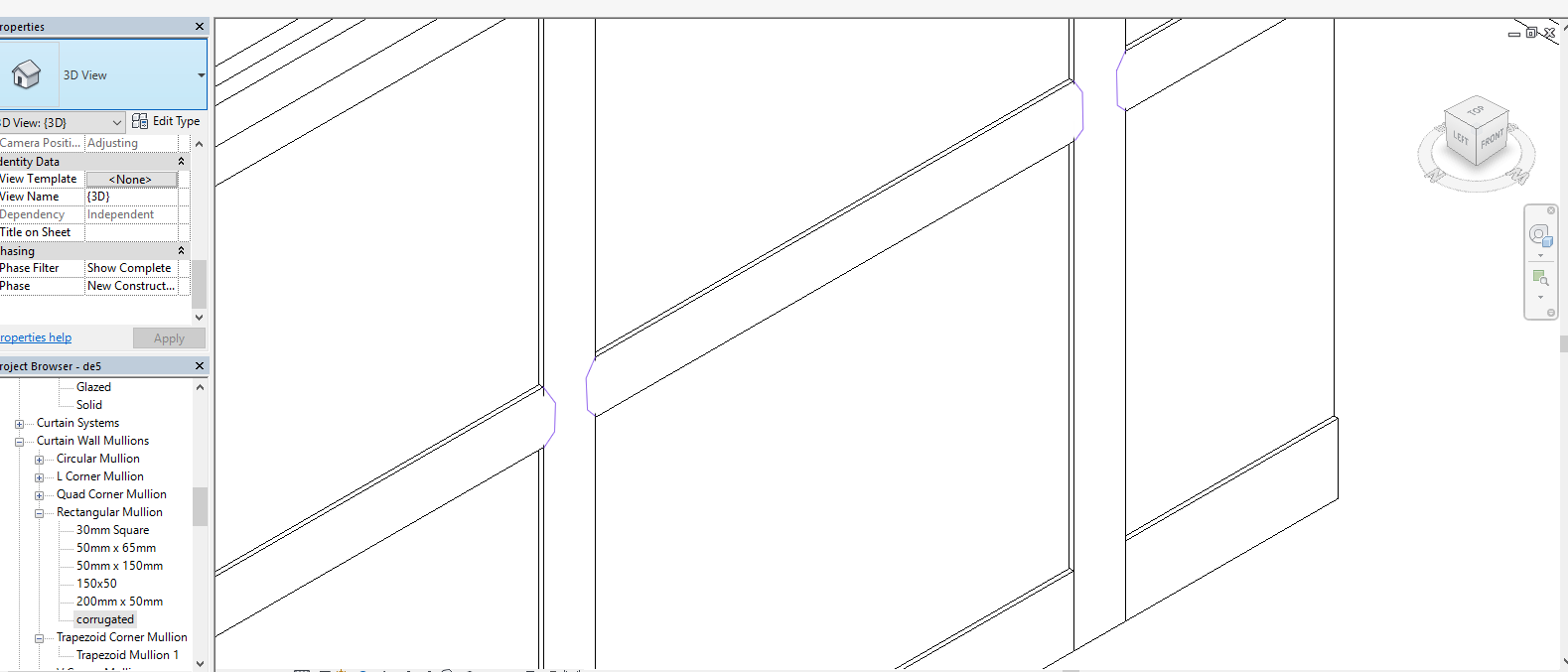

how can i edit the join profile of curtain wall mulliion?

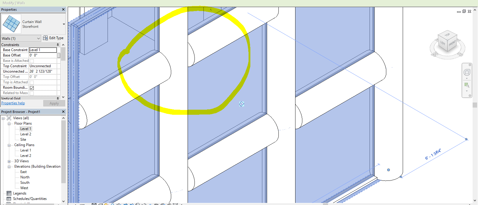

for my project i am using curtain wall as wood framed wall. and i need to show frame joins, but i can not change the join profile. check out the attachments. the blue lines are how i want it to show,,, is therer any way or workaround for this ? .. i really need help ,,

What you are in dicating would be a rounded profile.  Did you use that profile?  I never have so I don't know if even that will show what you want.

well, i've tried circuler profile,, but at the joining they don't join as i want. see the joining in attatchment

I did not think they would but still I was not sure.  If you would use in-place families instead of the CW muillons, you could probably get them to join like you want.
